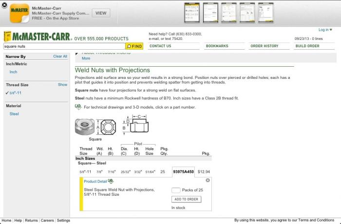

Pack of 25
- image.jpg (40.64 KiB) Viewed 900 times

I saw those, but I am concerned about the chamfered corners of the nut. With MIG, it would be no problem, I can squirt all the filler material I want all over the gap. But with TIG, I'm not so good at filling gaps, that's something I need to work on. If they had those with no chamfered corners, I would be all over them!MinnesotaDave wrote:Pack of 25
I'd think the chamfered corners to be immaterial to the finished product.
A bit of filler rod as your're welding them, and "done". Since you have to weld them anyway, why not have a filler rod in your off hand, for those gaps?
It's your game, though.
