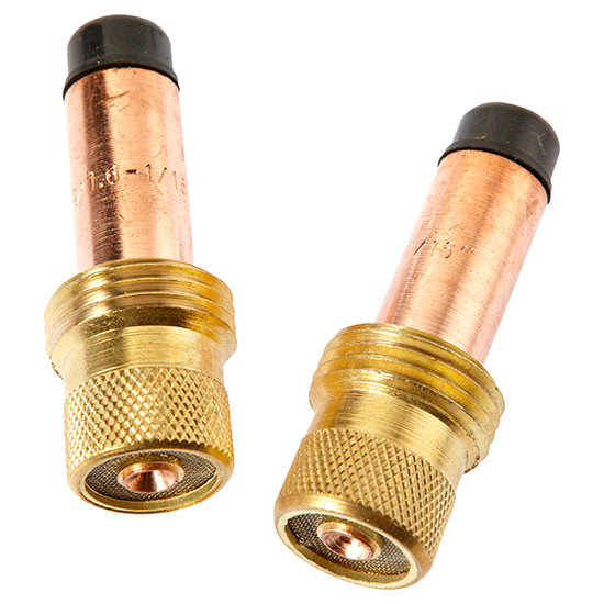

I purchased a "cheap" online gas lens kit as below.
Seems like an ok unit? Well every time i try weld with it i get horrible welds.
Green flame, sparks and a wandering arc.
Here is an example. Please dont hate me for i can not weld worth a shit!! :lol: But i do enjoy trying.

Next setup is the gas lens.
Cleaned up the other welds and tried to put down a couple with this damn lens.
Got porosity and all sorts of weird goings on.
Gas lens no good or operator no good?
Here it is all cleaned up.........
So all the other welds apart from the first 2 are with the gas lens.
I know all welds are bad, but i think you will notice the gas ones are worse.
I did try increase the flow rate to about 15 lpm which is a HUGE amount. Thats the top weld and come out better than others but still sparked a lot and green.
Any advice for this novice appreciated.

I am running an air cooled #17 No pedal, just the switch.
    Thu Jan 24, 2013 12:13 pm
I don't think it's you ! - your welds may not be god level yet but you got the idea fine so just more seat time will improve this - the difference between gas lens & regular certainly looks gas coverage issue - I don't use pyrex myself but what stands out is the low cost pyrex cup is parallel so the opening is noticeably larger than the diameter of diffuser screen - with ceramic cups that does'nt work well which is the main reason to switch up to a large lens instead of regular if going above around a N0.8 cup - I'm guessing that is around a #10 - I cannot explain the effect but I think it's just too big a cup for the screen size - the expensive pyrex cups tend to have a step in them ( or a secondary screen part way down )- as the gas lens is still threaded try screwing on a regular alumina cup no bigger than the screen - say a 7 or 8 & try welding - my guess it will work fine as unless the mesh is blocked badly from splatter gas should come out where it should - provided there are no air leak paths causing gas contamination.

i think its more likely one of the o rings is in the wrong place and you either have a leak or its obstructing the inlet holes.

What all your welds show is too little amps, or too much filler. The "grey" in the first picture is because you're hovering too long to get the volume of filler to weld in, because you're adding too much filler for the heat you're using. Also, the ceramic cup you used, yields crap for gas coverage. Use a quality gas lens.
The double O-ring on your pyrex cup looks odd to me. The picture is out of focus, so its hard to be certain. Screw the lens in tightly to the torch first, then wet and slip an O-ring on the lens. Then press and twist the pyrex on. You should not need 2 O-rings :shock: I would install the pyrex on from the bottom to help keep the O-ring below threads. But make sure the O-ring is rather wet.
The other element is the material thickness. Such thin material only cleaned on 1 side, will suck goop through and from the back. Stainless wire doesn't appreciate that, nor does mild steel wire.
Lastly, arc length. You should be "almost" touching the puddle to get good welds. If the gap is more than the filler rod diameter, you're too far away.

I decided to do a couple of tests last night. First i simply blew air through my normal setup then the gas lens.
Gas lens felt very restricted compared to the standard setup i had.
So i decided to cut one open and see whats up with them. Rough cutting has made it a little hard to see sorry.
It appears the gas runs from the torch into the top of the gas lens then out of 4 little holes and through the screen.
Those 4 holes are very tight and close to the outer body, which is why i assume i had restriction.
The screen is very tiny also. Far smaller than the cup as mentioned above. Seems very problematic right off the bat.
I think the correct thing to do now is first of all practice my welds..(heat, travel speed and arc length)
But secondly and more importantly i need to bite the bullet and buy a "Good" gas lens setup.
