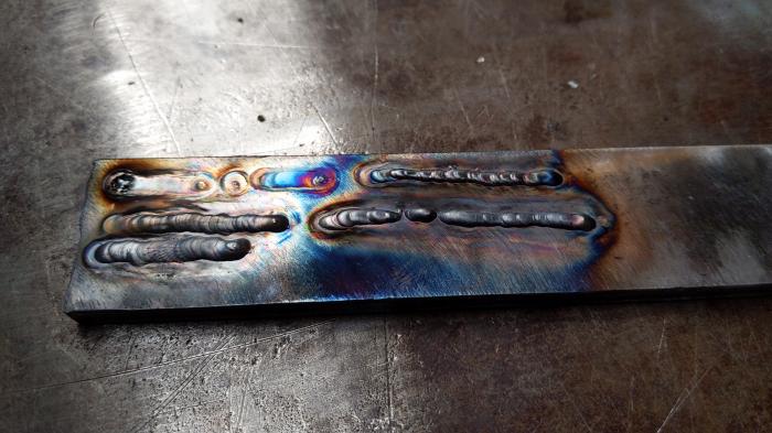

Got my TIG machine yesterday and haven't been able to run a single proper bead yet. I have spent hours searching for an answer but it's a little hard when you don't know what to search for
Another thing to note, the weld is sputtering so much and the bead erupts leaving little pinholes in the arc effecting area as well as fouling the tungsten without even dipping it, plus the tungsten turns grey after a single use.
If more information is required let me know and I will answer ASAP, I am keen to get back on track to TIG welding properly!!!

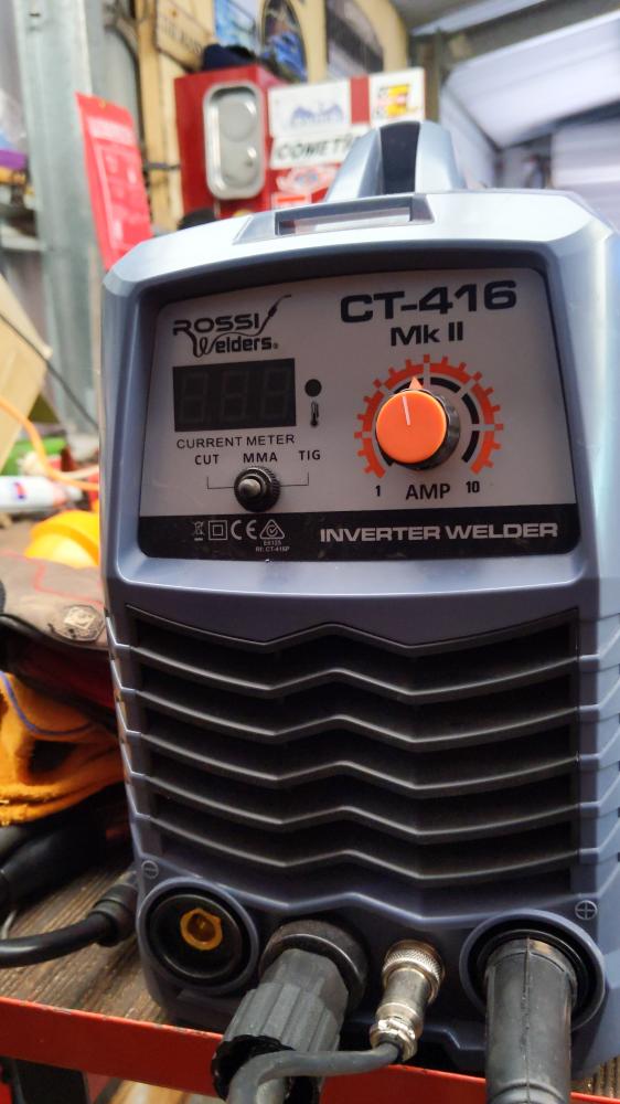

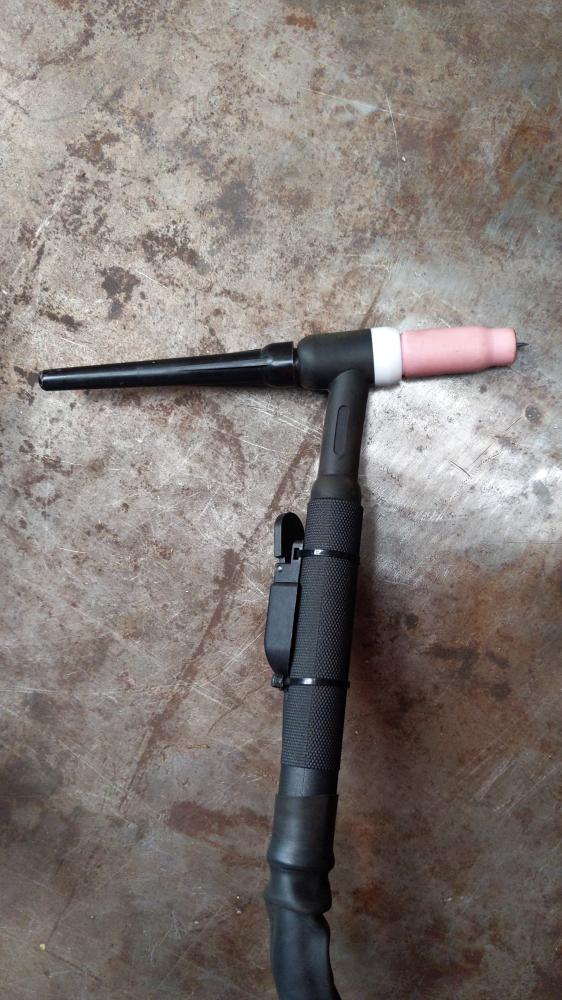

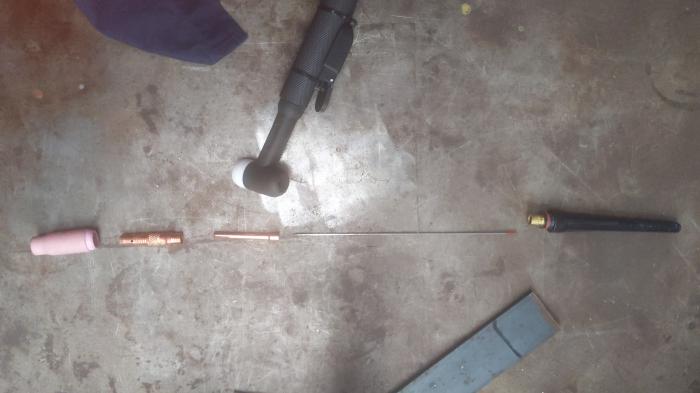

Thanks for the replies!
cj737 wrote:Gas flow issue.
Post a picture of your assembled torch, and the front of the machine, and your regulators please.
- PXL_20210624_003441239.MP.jpg (76.87 KiB) Viewed 1534 times
- PXL_20210624_003452247.jpg (50.29 KiB) Viewed 1534 times
- PXL_20210624_004506732.jpg (70.32 KiB) Viewed 1534 times
- PXL_20210624_004221930.jpg (98.21 KiB) Viewed 1534 times
- PXL_20210624_004404044.jpg (29.65 KiB) Viewed 1534 times
- PXL_20210624_004234705.jpg (22.38 KiB) Viewed 1534 times
The torch needs to be connected to the negative (-) terminal....can't quite tell which lead is connected to the positive (+) terminal in the pictures.

Sorry for the unclear picture, the ground is connected to positive and the torch on this machine can only connect to one port so unless that is the wrong polarity inside the machine it should be good.G-ManBart wrote:The torch needs to be connected to the negative (-) terminal....can't quite tell which lead is connected to the positive (+) terminal in the pictures.

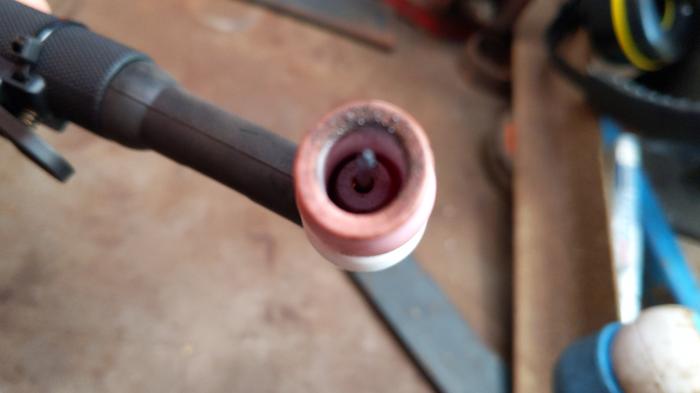

I have mostly fixed the previous issue I think by going down a size in cup and increasing gas flow, however now I am facing the issue of buying a cheap machine, the tungsten is still red hot when post flow stops and so I'm still getting the blackened tungsten after a single run. What would you guys suggest I do? Sand and grind the tungsten after every pass?

Exactly. If it is set for only 2 seconds you're going to be in for a world of exhaustion with so much tungsten cleaning. If you're dead set on using this machine, replace the torch with one that has a valve so you can just connect it directly to your regulator and you manually open and close the valve. I would be getting tired real fast having to either bump the trigger so many times and/or cleaning the tungsten all the time.Toggatug wrote:Sounds like your gunna have to bump the pedal or trigger after your bead to keep the gas flowing.

I couldn't find the settings for the particular machine but there is something about "gas after flow". i'd be looking in the sub menu for some type of adjustment...or just keep "bumping" the trigger switch after welding so you can keep the tungsten protected til it cools.
Your original issue could also have been caused by any sort of a slight breeze near your welding area. TIG can be particularly fussy with this, even to the point where a machine's fans can interfere with the weld even if the machine is several feet away from the weld area. Looks like you got it sorted...just keep that in mind if the issue presents itself again.
And it'll suck real bad if your machine is limiting you to 2s of post flow. I'd be surprised if they would design a modern machine to hard limit in this way, but you never know. Hopefully you can find a buried menu setting to adjust this. If not, the previous suggestion of going with a valved torch (i.e., completely bypassing the machine's solenoid) would probably be your best long-term solution, IMO.
