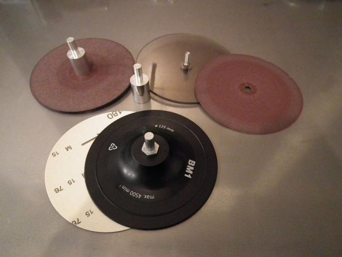

Hi,
I have had my TIG welder for a good month now and I wanted something simple and inexpensive to grind my tungsten electrodes. So I came up with this.
Its a piece of polycarbonate plate with a center hole for a carriage bolt, a turned aluminium piece with threads for the bolt and normal 180 grit sandpaper for a sanding disc for handheld drilling machines.
The idea came from the local hardware store where I got the sandpaper and the black sanding disc attachment. I mounted this is my drill press but I could not see what I was grinding because the sanding face was down. So I made this for facing the sanding side up.
I know the sandpaper does not hold up fantastically, but it's cheap and I don't have access to diamond wheels here.
I use my cordless drill to chuck up the tungsten while sanding it, just as they do in all those videos I have seen.
I had some trouble with my arc, so I took a closer look at the sanded tip of the tungsten using an USB microscope, and it appears that I was running the cordless drill way too fast (actually I just gave it full speed in high gear = 1600rpm). The 125mm/5" sanding disc was running about 1200rpm. And this caused twisted sanding marks. I was not able to see this with the naked eye, those tungstens are 1.6mm 1/16".
In those videos showing the chucked tungsten in the cordless drill, they never tell you how fast they are going, and it's not possible to see it either.
So I tried to the lowest speed in high gear on the cordless drill and upped the sanding disc speed to 1500rpm, and look at that, much better!
So basically my tip today is run the cordless drill slow on your finishing tungsten grinding pass.
As I'm a newbie, I still wonder about a few things.
Those sanding discs are dedicated to only grind tungsten. And I have labeled them on the back for which color band tungsten they go with. But can the normal type sandpaper contaminate the tungsten? Do I need to wipe down the tungsten after grinding as the sandpaper generates some dust? They never clean the tungsten in the videos, but does that mean it's not needed?

clavius, thanks for the link, those discs could probably replace my current sanding paper solution as those are around $1.30 each and rather quickly wear out.
I see those diamond coated discs are also available in 5" so they would fit my current setup with minor changes (they are 16mm arbor hole where I have 8mm now, but that is quickly fixed on the lathe).
Now, what grit would be best, 180 is actually a bit high for the final finish to my liking but that was the only option besides grit 60 in the hardware store.

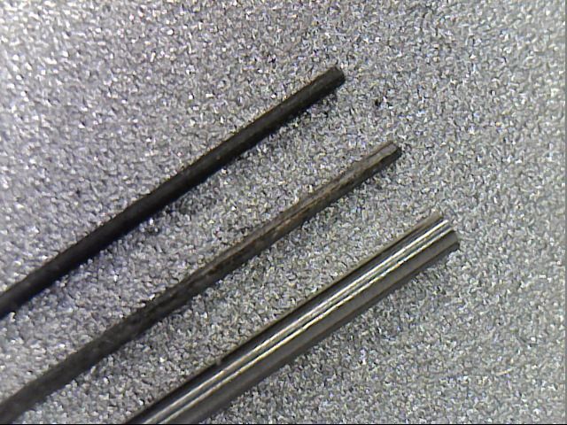

Since this thread is still going, I have another question.
I received some CK Worldwide 0.5mm/0.020" 1.5% lanthanated tungstens today. They are all matte and almost black, not silver and shiny as the CK 1.0mm/0.040" 2% lanthanated tungstens I already had. The CK 0.5mm/0.020" thoriated tungstens I got by mistake, are somewhere in between, not silver, not all black but mostly matte grey.
Is this OK for brand new tungstens? I mean, will they act contaminated?
I'm thinking the supplier may have had those is stock for a long time, maybe those small tungstens are just not sold very often, and due to long storage, the tungstens have oxidixed?
The picture shows the 3 mentioned tungstens, to the left/top the black 1.5% lanthanated, middle is the thoriated and the bigger on the right/bottom is the 2% lanthanated.

I've used a lot of .040" but never seen this, or have I heard of tungsten oxidizing (not that this means it doesn't)Futterama wrote:Since this thread is still going, I have another question.

Why are you choosing 1.5% Lan over 2% thoriated? If you're going use use lan tungsten all reviews I've seen recommend the 2% lan over the 1.5% lan. I do use 2% lan myself, but in the past always 2% thoriated for DC welding
My .040" are looking fine and shiny, it's the .020" that is looking very different.LtBadd wrote:I've used a lot of .040" but never seen this, or have I heard of tungsten oxidizing (not that this means it doesn't)
I would rather just use 2% lan all around, as Jody recommends. But my supplier did not have 2% lan available in 0.5mm/0.020". If they should get it for me, I would have to buy 100pcs and wait for 3 weeks. At other sources, I would have to pay an absurd amount for shipping. So I went with 1.5% lan as my supplier had that in stock, thinking I would try it out as I'm still so new to this that I can't say 2% lan would be any better for my application.LtBadd wrote:Why are you choosing 1.5% Lan over 2% thoriated? If you're going use use lan tungsten all reviews I've seen recommend the 2% lan over the 1.5% lan. I do use 2% lan myself, but in the past always 2% thoriated for DC welding
The 2% thoriated was shipped to me instead of the ordered 1.5% lan as a mistake, they corrected the mistake but the received 1.5% lan are black, which puzzles me.

So I've been in contact with CK and this is their response to the discolored tungstens:
I looked at our stock of T0207GL and there is some discoloration on the electrodes. I did some digging and it is actually an oxide layer. The surface oxide layer can be more aggressive in hot humid weather. I think you guys have been experiencing that this year. If you take a clean emery cloth and run it up and down the electrode, it will clean it up and be back to shiny silver. The small diameter, .020” (.5mm), would be more susceptible to having a more visible oxide layer than a bigger diameter. I am sure that even the first striking of an arc would burn it off. I don’t see this as being anything to worry about but just to cross your t’s and dot your I’s put an emery cloth on it and remover the oxide layer before you weld.
Coldest summer in a hundred years in Scandinavia this year it was.....hot humid weather. I think you guys have been experiencing that this year.

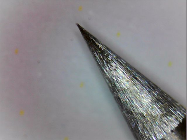

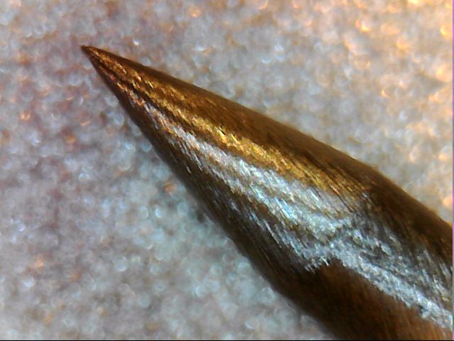

I just received my diamond grinding discs from ebay today:
http://www.ebay.com/itm/6-Grit-60-to-30 ... 2749.l2649
http://www.ebay.com/itm/4-80-3000-Diamo ... 2749.l2649
These work fantastic, much better than sandpaper!
Now, I learned that sandpaper is not the best for metal grinding, so I got some emery cloth to try out too, and I'll compare to the diamond discs.
The diamond discs are 120 grit and 320 grit. After grinding using the 320 grit, the tungstens look like on the photos. The first photo is a 2mm - 5/64" tungsten, and the second photo is a 0.5mm - .020" tungsten.
Do they look like they should or do I need to get a finer grit diamond disc for the final grind?
