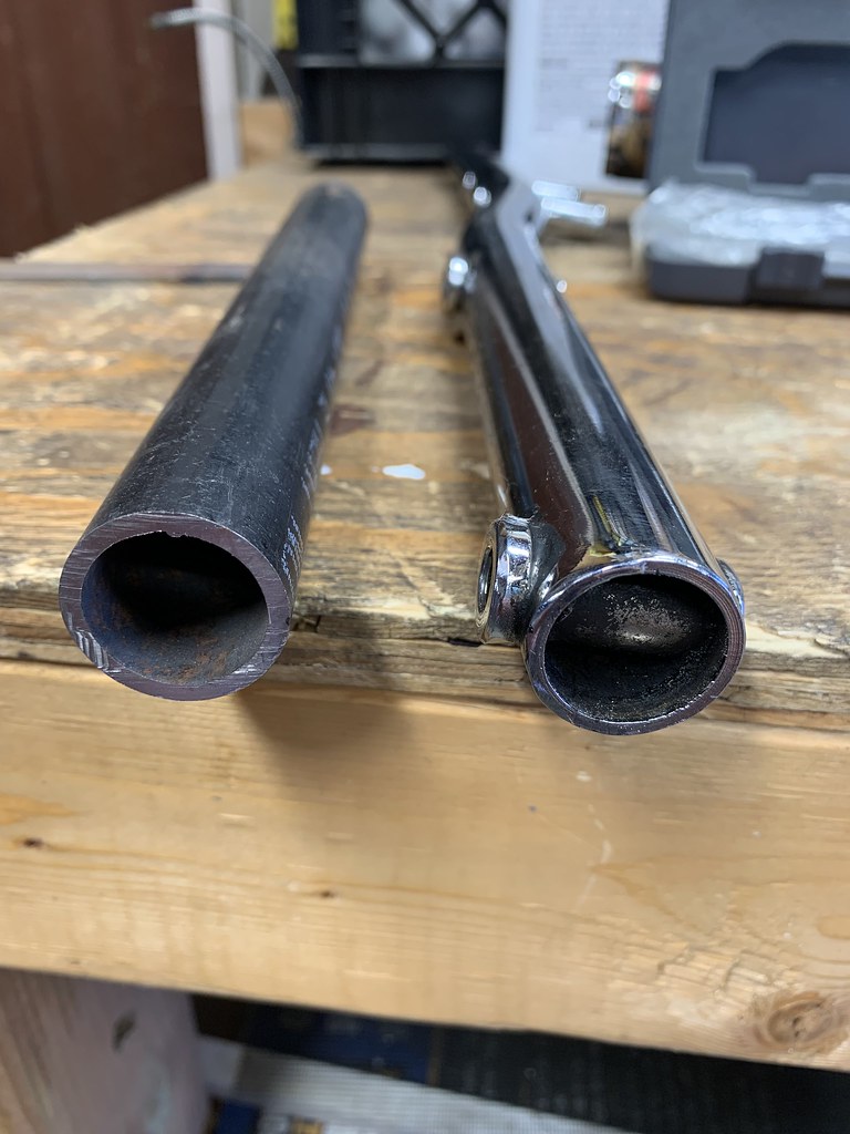

It was just a guess at the time, but now that I have the part off, I was in the ballpark, sort of.
Looks like it started out in life pretty close to a 3/4" Sch 40 pipe. Then drilled, and 4 threaded inserts/stand offs welded in. Nominal dimensions --> ~1" outside diameter, and at the end where I could get a measurement..... ~0.810 inside, wall ~0.090.
The pics are probably overkill now. But I have 'em so might as well post 'em.
The pipe on the left is a scrap piece of 3/4" Sch 40 pipe. Just thrown in for a visual comparison.

So does that piece support the exhaust pipe? If so, probably the weight of the exhaust (way thicker than needed tubing) is putting stress on the end since the bracket is not connected to the frame at the end. Does that make sense?
Seeing the crack, I’d probably use a cut-off disc and slice into the crack to cleanly open it, then weld it back shut. Use a tubing sander and grind the weld flush, then have it re-chromed. You might also see if there’s a way to connect the end of the support closer to the far end to help with the stress.
