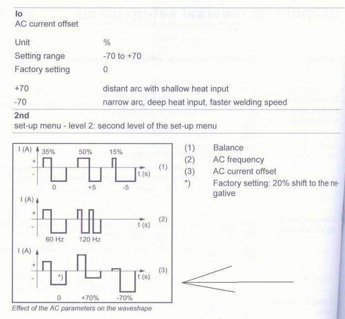

Zank you are very good well done . I follow and i hope I get close to your welding . One thing only ,what thickness of the welding
rod please ? ( diameter ).My machine is fronius who has a similar adjustment but not exactly different amperage . So i will use this and
i will try to see what happens (it is in the bottom line with the arrow ).

- AC Io.jpg (42.5 KiB) Viewed 5370 times

Jonathan the Aspect has the same features with the acceptation of splitting the wave, triangle one side square the other side etc. You can split he wave with the V310T but it has no adjustment of the EP EN beyond the balance.Superiorwelding wrote:zank,
