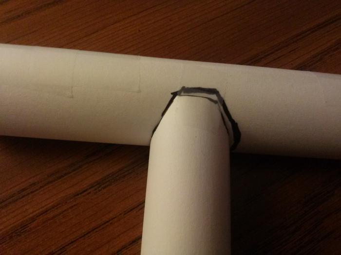

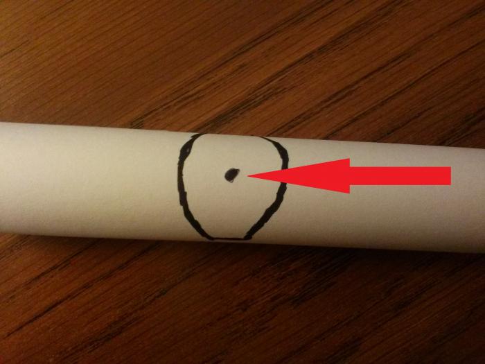

Make sure you are not gonna weld on a tube that is totally closed off on both sides. If you weld on an enclosed space the air pressure will blow out your puddle when you try to close the weld. To avoid this issue drill vent holes in the tubing at the junctions. If you do this thru out the frame, you will never have a blowout.
Here is an example lets say we have this junction. (please excuse the use of paper for tubes grabbed it out of printer instead of going outside for tubing. its freezing outside
Drill a small hole in the center of the junction 1/16 or 3/32 inch is normally enough. This will give you vent holes and also if you decide to backpurge that option is there also since the entire project will be connected by vent holes.
The other thing is get your fit ups perfect and I mean perfect. If your fit up is perfect with no gaps you will not be putting excessive heat in the joint trying to fill the gap. Excessive heat leads to a brittle heat effected zone.
Clean the tubes at joints to bright shiny metal. Remove that thin layer of mill scale, Welds easier and cleaner. don't forget to clean the inside of it too It will also make a better looking weld too.
DO NOT take an OA torch to your tubing trying to normalize, anneal, temper or any of the voodoo heating changing methods. IF you have a part that needs to be heat treated lets say you built a spindle with 4130 and used 4130 filler which is a totally different then what was suggested earlier. Take it to someone that has a oven and experience heat treating parts. they will know what temp part needs to be heated to. What temp it needs to stay at for certain amount of time and how to cool it down properly.
For just welding 4130 N tubing with TIG using ER70-S2 or ER80-D2 you just need to let part cool on its own and not overheat the tubing. if over .120 wall then preheat tubing to avoid it from cooling to fast.
cant type tonight edited this thing several times
not sure of your welding experience with tubes just throwing some stuff out there if you already know it just disregard it.
