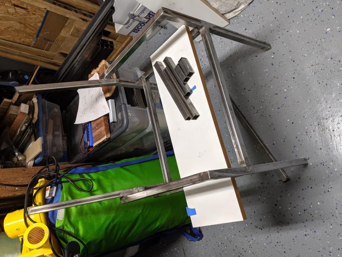

I'm a new welder - I have a super inexpensive wire welder from amazon, and am working on building some chairs out of 16 ga 1" square steel tubing/
On the butt welds (t-shaped), I am doing "ok", but I have 2 x 45* miter welds on each chair (where the arm meets the leg), and I can't stop blowing through the gap. Also, i'm using a metal cut-off saw that has a 45* setting, but the cuts are still such that the outside of the miter has a 1/16" gap at 90*, and I can't figure out how to weld it "closed."
I'm using .030 wire, but just ran out of a spool, so could get a different size if y'all think that would be better.
My welder has 4 power settings (Min & Max x 1 & 2....fancy!), and has a wire feed speed knob with 1-10.
I'm prepping the edges by flap sanding a small bevel into the corner sections, and wire wheeling off all the mill scale around the weld. I've found that at the power "Min x 2" (basically 2/4) + wire feed in the 6-8/10 range, I can get a decent looking weld on the butt sections, but here's a picture of the miter welds....prepare yourself for horror!
Any ideas or feedback VERY much appreciated, thanks!

Don't be too hard on yourself. The reason why are able to weld the tee joints but not the butts is because there is heaps more material to both back up your weld and carry away the heat. It's not easy for anyone to butt weld 1.2mm or 16g steel regardless of skill. It just wants to burn through. The easiest way to get by is to do small spots, some call triggering or stop start, to do a spot of weld, stop, let it cool, move, and repeat. That's slow but it gets the result you need. Another way is to tack a piece of material inside the tube to back up the weld. It'll become part of the joint and stay in there. That gives the effect of welding twice the thickness of your material and eliminating burn through.
Check your voltage and wire feed speed. It looks like you are running hot and you are going to want to run as cold as you can. Are you running innershield? No need to prep/bevel the joints on that thickness since you will get full penetration (in fact, you're better off not to bevel them so that you have more base material in there).Here is a video of manual pulse welding. This guy is pulsing to fill a gap, but the same can be done for thin material.

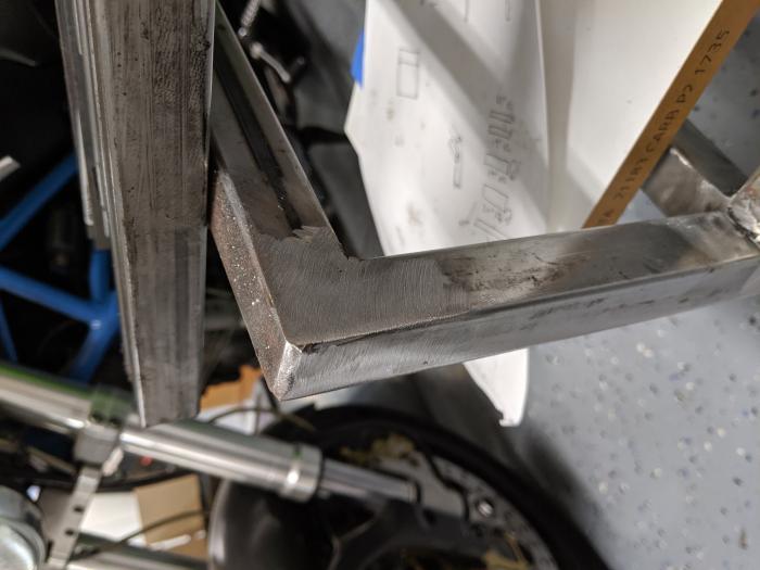

Thanks for the feedback tweake! I'll attach some pictures of the "better" welds here - still pretty ugly, but I have lots of grinding disks and flap sanders, which can fix anything, right?!?! I may well upgrade to a better welder if I am doing more projects, for now, looking to "do more with less" - and both for the $ and the space, can't justify another tool in the shop on the metalworking sidetweake wrote:do you have a pic of your good welds?newbie_welder123 wrote:Hi All!
the grinder may pretty the welds up but thats pointless if the welds break because of the issues.
i would not want someone to sit on the chair and have it fail.
have you tested any of your welds?
i was gobsmacked when i first tested my early mig welds and they failed. even when they look good they can be bad.
one of the traps with mig. its a real eye opener when your good welds don't hold up, but its very good to learn from.

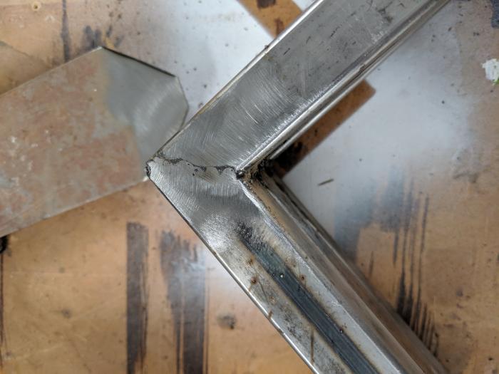

Hi Tweake! I'm attaching some photos of the welds I felt better about, in addition to the ground down versions attached to my last post. In terms of testing it - I am also attaching a photo of the first chair in semi-done format. I plan to put wood planks across the seat and back, and paint the steel black - but you can see the form. I have put a scrap board across the seating area and sat (with feet off the ground) with no movement/stress noticeable in the chair. I weight 220 #, so not an insignificant strain. I've pulled at the miter joints with some elbow grease and the don't move. How should I test the welds, given my situation?tweake wrote:have you got those pics of the "better" welds?newbie_welder123 wrote:

flux cores can be unforgiving. you need the right amps, volts and stickout. sometimes it has to be absolutely bang on to weld good.
its hard to tell with your welds due to the grinding, but it looks fairly horrible. sorry but i'm honest.
are you seeing the puddle?
if you can't see the puddle your screwed. set your helmet to a better setting, get yourself into a position where you can see the puddle.
the welds look all over the place like your wobbling around. get some support, lean on something. be steady use two hands. often rest on elbow and use that hand to steady the torch with as well.
if your nice and smooth but the arc is stop/starting all the time then you need to check the setup.
runs some beads on some scrap, get it dialed in perfectly. there is a lot of things to adjust with mig.
testing. weld a small T joint, put it in the vice and break it. see where it breaks. post pics on here would be good.
i've done perfect looking welds only to have it pop off like it was just sitting there.
you should not need any backing inside the tube. it should be easily within your welders ability. you could even stick weld that easy enough.

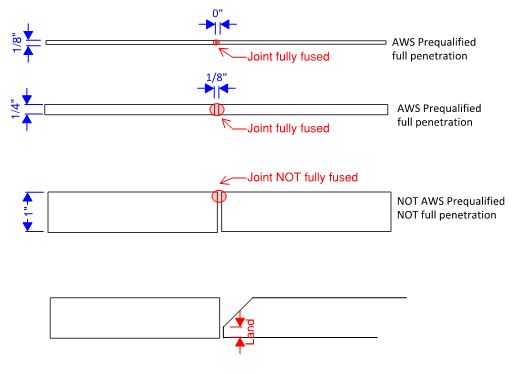

I originally asked if the wire was flux core or not and I'm not sure that was ever answered. What is the spec on the wire you are using? Are you using gas shielding (i.e. is a bottle of compressed gas connected to the welder)? It almost looks to me like you are using outershield wire with no shielding gas because of the soot, spatter, and appearance of the bead.
Attached is a sketch of the cross section of a few joints. This may be a little too technical for your stage of knowledge, but I thought it might help. AWS (American Welding Society) is the government body for structural welding (kinda like a building code). They have a number of prequalified weld details, which means that you need not build and weld and mock-up of these joints for testing in order to prove their suitability. The first two joints are prequalified butt joints that will achieve full penetration (full fusion of the joint) provided that the plate thickness root opening (0" or 1/8") are maintained along with other technical variables. The purpose for showing you these two joints is to demonstrate that thin materials will fully fuse together without beveling. The 3rd joint is 1" thick, with a 1/8" root opening and clearly it is not fully fused. If you wanted to full fuse the material, you would have to bevel one side (or both sides) and build up the weld with multiple passes. The bevel that I show does not run full depth of the joint. I left a "land" of bout 1/8" and that is there to avoid blowing through the material.
I would suggest you go to your local weld store (not Home Depot or tractor supply, but a Praxair or Air Liquide and ask the guy if he knows any welders that can help you learn. You might just find someone who will charge $20/hr or $50/hr and after a couple hours you will be a lot better off. Once you feel more comfortable, you can start to look at and learn from the videos on the weldingtipsandtricks youtube channel. But you really should have someone around to look over your shoulder and guide you.
