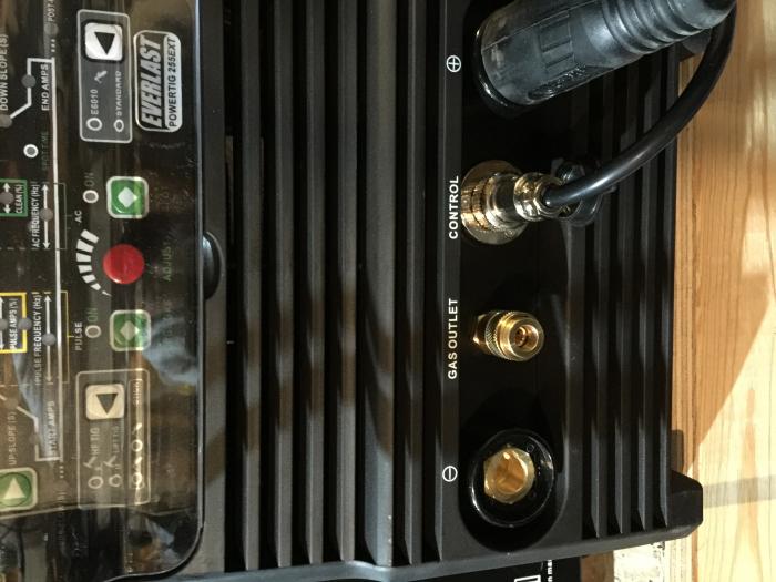

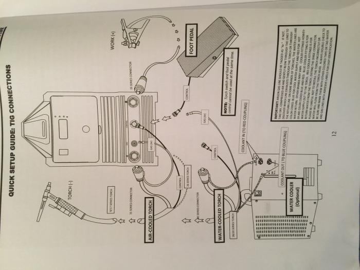

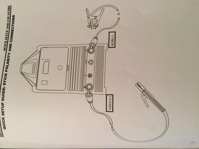

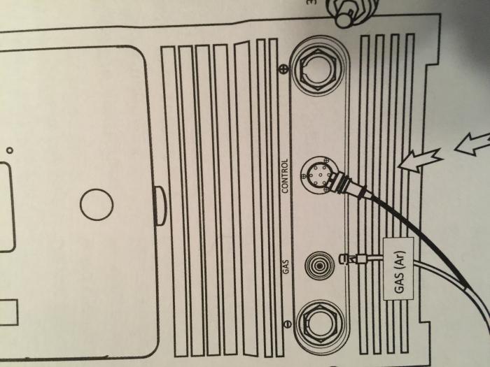

I hope you don't mind me sending all these photos I wanted to try out the stick function I think Paul's on the stick is absolutely crazy never seen it before anyhow I'm a little bit confused because if you see the photos hopefully the whole photo came through but the one photo shows a drawing of the machine with the negative on the left and the positive on the right and then the next one shows the positive on the left now my understanding was that I plug the tig torch in on the left Side of the machine with ground on the right Side of machine if you look at the photos it changes polarity in the sketches so if I go by the photo the stinger and the tig torch should be plugged in on the left side of the machine and ground clamp is on right side in both cases with the tig and the stinger??? If this is the case then it must be switching the polarity inside the machine? I just ran out to exchange the prestone for the RV..... I actually had the Rv stuff in my hands and at the cash earlier but I read it is no good for heat transfer, so I put it back and picked up the prestone. We have 50 gallons of Propylene glycol on a jobsite (we use it for our snow and ice melt systems (for driveways and ramps to underground parking) I am at a store called Canadian tire which is a bit of a higher standard than harbour freight and then we have princess auto which is the exact same as harbour freight . The funny thing is that the store called Canadian Tire has absolutely nothing in the store made in Canada! All Chinese junk but they have lifetime warranty on everything so if you pick up a socket set and you drive the crap out of it break it and return it they will give you a new one but they sell Lincoln strictly mig machines here. Princess auto sells what's called Pro point. What's your take on the stinger plug in on the everlast?

David, these pictures are, indeed, confusing. If polarity is switched within the machine, why are the terminals marked?
TIG will be electrode negative, while (almost) all stick will be electrode positive, yet the drawings show both connected to the same terminals.
This suggests to me that polarity can be switched electronically at the panel, much as it can with a big switch on a Miller SW250

Polarity is dictated by how you plug the work lead and ground in, there is a switch for AC/DC and that's it. Ground in Positive terminal, DCEN. Ground in Negative, DCEP.Otto Nobedder wrote:David, these pictures are, indeed, confusing. If polarity is switched within the machine, why are the terminals marked?

I would imagine that it's significantly cheaper, and lends to the ability of packaging smaller when you don't have a massive switch inside to turn.
Dynasty welders are set up similarly, in regards to having AC or DC button, and it's up to you to correctly install the leads to get the desired result.

I have a 210 EXT and the first time i used it i reversed the leads and pretty much exploded the tungsten. That's when i figured i should RTFM.
I don't know about the 255 EXT but i'd bet it does not switch polarity automatically.
David, are you familiar with polarity (electrode negative, electrode positive) as it applies to welding, and why it matters?

On the new version 255EXT, the one pictured (has a gas purge button, spot timer and 4 fan cooling) when facing the machine, the positive electrode connection is on the right and the negative electrode is on the left. On the previous model 255EXT, these were switched. The reason they were changed was to accommodate the additional internal electronics installed during the upgrade. So, most likely, if you have a new manual, they just forgot to replace or change one of the pictures when they updated the manual. The information is correct as indicated, you just have to install the leads according to the manual on the correct side as marked on the welder.
How do I know?
There I was ... I was lucky enough to call Everlast at the right time and got one of the first new version 255EXTs before it had even been advertised. At the time, I had never touched the TIG welded before. I had printed the manual off of the website but the new version was not even on the website and the manual was for the previous version. I RTFM several times over the next few days, and watched a lot of Jody's videos, crash course in TIG welding. When the welder came in, I hooked it up, just plugged in the leads on the side I memorized not even looking at the welder itself. The welder (or maybe weldor) welded like crap, blew up the tungsten. I checked gas and tried a little messing with the controls but was afraid that there was damage in shipping and didn't want to damage anything more so I shut it down and sent Everlast a note.
That was Saturday evening, early Sunday morning I got a call from someone at Everlast, don't remember who it was but I think someone involved in the design. He had me go out to the garage and look at the welder and tell him which side the leads were hooked up on. Just about that point, having done some studying on this, I saw the positive indicator on the welder and the torch lead attached to it, bingo, lights on, feeling really stupid at that point. Anyways, the guy at Everlast was very nice, we shared a few laughs and he told me suspected the cause because they had changed the leads with the new welder. I changed the leads to hook up correctly and the welder has performed flawlessly every since (though not necessarily the weldor). Anyways that is why I suspect that the manual has the leads on different sides on the drawings.
Couple things though. I was impressed with Everlast customer service calling on a Sunday morning to ask about the issue. I thought that was best in class. I was also impressed that who I talked with was quite patient and affable with my ignorance, as he had gotten up on a Sunday morning to call. Finally, I have learned to weld on the 255EXT, hours on hours of practice and modern art for the recycle, made about every welding mistake a person can make in learning and the welder just keeps on working. For me it has been an excellent machine that I continue to use regularly.
