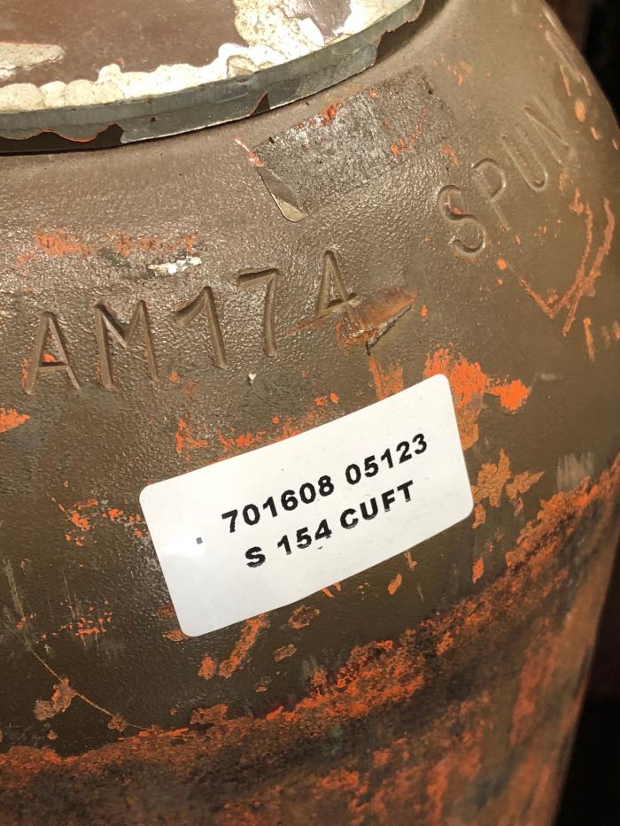

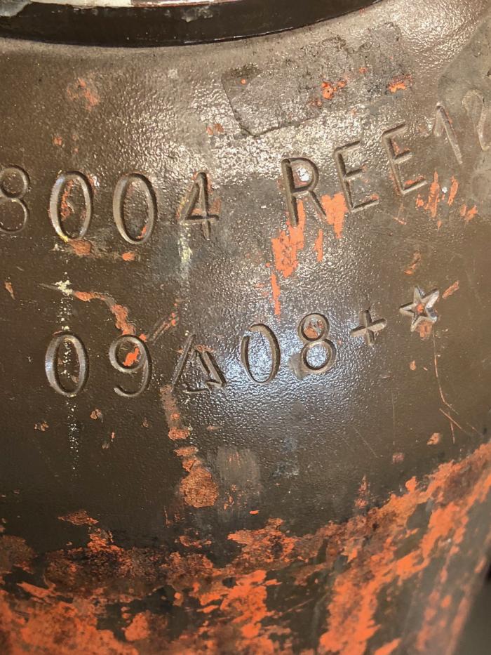

Gas
I need to pick up a 100% Argon bottle for TIG. I've read about the dangers of buying Craigslist "customer owned" bottles and think I have the lay of the land http://www.ebay.com/gds/BUYING-A-GAS-OR ... 737/g.html. The local AirGas supplier says they refill customer bottles, or swap out with smooth-necked bottles.
Welding at 10-20 CFH with an 80 CF bottle only gets you 4-8 hours of weld time before refill. That doesn't seem like much time.
The local welding supply isn't open on weekends, so refilling during the week will be a PITA.
I'm thinking of going with an S sized bottle, but I haven't seen any of these in person quite yet. I've got a Prius (yeah, yeah, I know, don't hate me) so transporting is a concern. That said, I did stuff a 5.7L Buick short block in the back at one point to go to a machine shop. The irony of that moment was not lost on me
That's a long way to say, do you think an S or K sized bottle is too large for a casual hobbyist?

GAS - lease a bottle from your LWS. Its much, much easier. An 80 tank is small and it tends to run low at the worst possible moments. Either you're too low on a Friday to finish your work through Monday, OR, you exchange and refill it and are wasting 1/4 of your gas. Leased bottles can be refilled by any location of that store nationwide.

I rented a 330 cf tank; local suppliers don’t deal with any customer tanks larger than 80 cf and that seemed annoying. And larger tanks are a lot less for the gas itself.

I ended up buying my bottles.
But we seem to have a different system here in oz.
I have 2 D sized bottles, when empty I call the supplier I bought them from and they deliver a serviceable full one. You just pay for the gas, a price that in the usa would make your eyes bleed.
Bottles here have a 10 year life before inspection.
Also they run about 500 psi less than the monthly rental one from boc, liquid aire and core gas.
Still im about 300 a year in front over renral of 2 bottles.

GAS - I ended up buying a full 100% Argon/ 154 CUFT customer owed bottle from a guy off of Craigslist for $150. He's an older gentleman who runs a muffler shop, and it's his side business to sell bottles. He threw a gauge on it to show it had 2,100psi, which he said was an indication that it was "full". Then he spent a long time giving me advise about bottles, refills, and welding in general. He said if any places give me trouble he'll have his guy swap it out. So that's a nice worse case scenario. I had called three of my LWS's and they all said they'd do refills on customer bottles this size. This particular bottle is about to expire (thus the price) and will need to be hydro-tested, which is fine. The LWS all say it'll be $30 to have that done.
- IMG_0478.jpg (131.66 KiB) Viewed 6250 times
- IMG_0477.jpg (110.75 KiB) Viewed 6250 times
- IMG_0479.jpg (161.5 KiB) Viewed 6250 times
