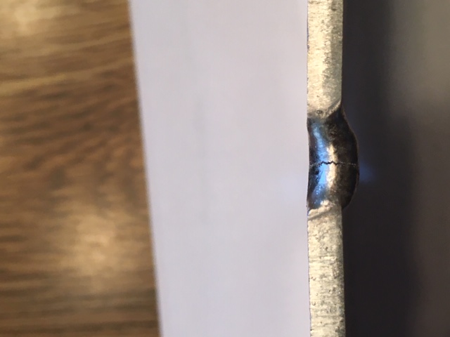

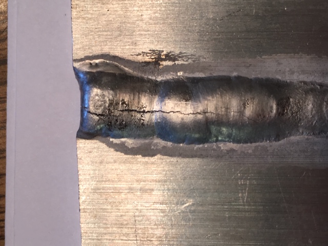

Got some torch time today. Had 2 - 3" wide x 1/8 thick scraps of aluminum laying around.
Primeweld 225
100% argon - 15 lph
# 6 regular cup
3/32 - 2% lantholated
140 amps - full pedal
A/C
3/32 4043 filler
65% ish cleaning
Had issues. My tungsten seemed to round off rather quickly. Also, my filler was melting outside of and away from the puddle making a ball on the end that....jumped onto my tungsten as soon as I tried putting it in the puddle.
Yeah, I think I snapped out of the weld at the end and that made the fish eye, which aided in the crack. The welds look dull and I think I had too much heat. Maybe back down to 130? Am I on the right track?
***Edit*** Actually, the crack is at the START of the weld

Reducing your amps is not the answer. Understanding the “hot short crack” is. Starts and stops of ally welds on their length are very prone to cracking if you don’t add enough filler, don’t taper your amperage down at the end, and don’t use enough filler wire.
If you’re running 15lph with a #6 cup, that’s way too high. Probably nearer 5lph, and be sure to use a postflow of at least 5 seconds on the end of the weld.
Filler wire balling before being introduced is symptomatic of too long an arc, and the wrong angle of adding filler/torch angle. Closer to 90* for the torch, nearer to 45*-60* for the filler. Get it stuck in there, and draw it out, stuff it in, pull it out. Don’t dawdle.

Highly likely there’s a hole at the start of the cracks. When you end a weld you might be leaving a hole. If you don’t grind it out or burn through it it becomes a stress riser and a creator of cracks.
to much cleaning, i suspect its closer to 60%. try around 70%. if its fairly clean material 80%.eelman308 wrote: 65% ish cleaning

the less cleaning action the less heat the tungsten has to deal with and less rounding off it does.
melting filler, arc to long, to flat torch angle. plus 4043 is a bit lower temp. i usually find 5356 easier.

From the pic it looks to me like too much heat in the weld. When you start to lose the ripples caused by dipping the rod, you are definitely too hot. Turning down the amps may or may not be the answer. 140 amps on 1/8th inch material is a lot but not if you are proficient and can move fast enough. Heat input is complex, its not just the amps but how long you dwell on the part. Jody has an excellent video demonstrating that 120 amps can actually put less heat into a part than 80 amps when TIG welding.
It could also just be wrong combination of filler metal to the base material as someone already mentioned. ESAB has good reference material on hot cracking: https://www.esabna.com/us/en/education/ ... alloys.cfm

Hmm. OK. Yeah, in hindsight, probably had the torch leaned over too far. I'll correct that.
Gas flow...thought the rule of thumb was 2x the cup size. I'll back it down to 10.
Considering backing down voltage to 130. Used that setting previously and seemed to do OK. That may let me catch up and not have to travel so fast.
Scraps are 6061-T6511. Did use dedicated stainless brush and acetone.
I'll cut back Hz from 100 to 60 and cut back on cleaning
I have 1/8 filler at my shop. Both 4043 and 5356....swap it out?
Did I miss anything? I appreciate all the suggestions. Now I'm itching to get back and try it.

one of the common problem with aluminium welding is running low amps and traveling to slow. the problem with going slow is your pour more heat into the part and end up overheating it. so you have to go at a decent pace. better to be hotter and faster than cold and slow.G-ManBart wrote: For 1/8" thick aluminum I'd set it for 125A
the 140 amps is ok, a bit on the cold side if anything. 125 amps is way to cold. you want the puddle to form in a few seconds. if your having to wait your way to cold.

Hot short cracking with 4043 is common. Its a base metal dilution issue. I am not smart enough to explain it, maybe someone else here can pick up the ball. I am sure you can Google it.
I have run stacks and stacks of coupons and projects with 1/8" thick aluminum, with many different machines set at 125A and never had any sort of problems....puddle starts in a reasonable amount of time (1-2 seconds going off memory) and I can travel as fast as I can feed wire. I don't see how there's any chance it's way too cold.tweake wrote: one of the common problem with aluminium welding is running low amps and traveling to slow. the problem with going slow is your pour more heat into the part and end up overheating it. so you have to go at a decent pace. better to be hotter and faster than cold and slow.

hello. been looking at the pictures ..... to my OLD eyes, it appears that there are several stops and starts, which may cause reason for the cracks to start and follow the weld bead. At the start and stop points there is porosity which again be cause of cracking. You may aslo be pulling junk from the bottom side of the material. Your gas flow is kinda heavy ... LPM is about the size of the cup (6 cup, 6 LPM) Some of the posts in here have shown 2x the cup size, BUT it is in CFM .... different animal than LPM. Also, the tilt on the torch should only be minimal, you just want to be able to peak at the tungsten and keep the tungsten close to the work. Practice and be patient. Every day is a learning experience. Don't believe me ,,,, watch the service manager at auto repair facility when he says,,,HMMM, never saw that happen before.

Update on implementing your guys recommendations:
Cut back on flow to 8 LPH
Put up slope and down slope at 0 as I read in another thread that can affect pedal response on the Primeweld.....IT DOES
Cut amps to 135
cut Hrz to about 60
cut cleaning back as well
Used 5356 filler 3/32
Things went way better this time out. Can't thank you all enough for the suggestions. One additional issue, I noticed the dial for auto darkening got moved from 8/12 down to 5/8. This caused me to be only seeing a ball of arc rather than the actual puddle. Probably bumped it taking the helmet on / off, laying it down, etc. Put some tape on it and....WOW !! I can actually see what I'm doing now.
Still not as good as I'd like, but I'm more confident now. Played with some coupons after ward as well. Yeah, I still have some work to do.
Thanks again for helping the new guy!
**Edit to add*** Also concentrated on my torch angle and arc length. Yes, it was laid over tooo far and now that I can see, was able to shorten arc length.
