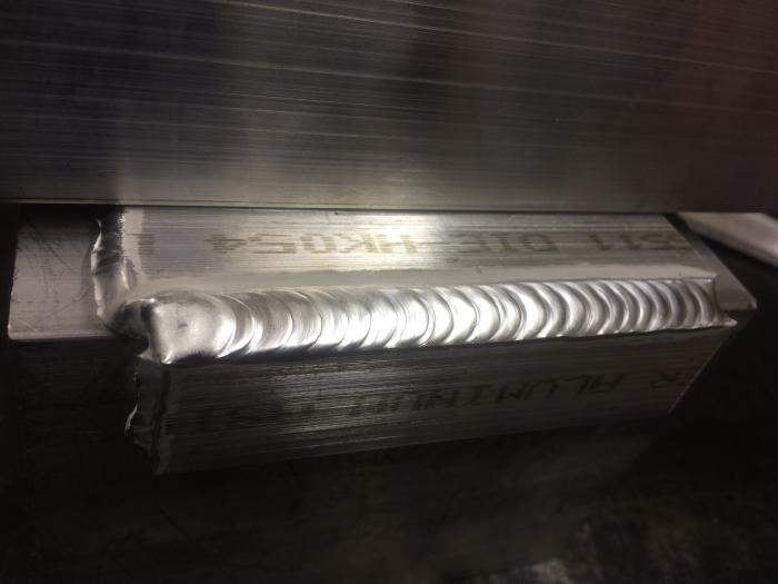

Re: 1/4" aluminum weld
Thanks this is the one that I could bust apart split right down the middle of the weld
I will stop by the LWS for some 4943
yes 6061

The pieces were small. 5"X1" 1/4" thick. Took a few hits with the hamer I know the heat build up is a lot on the small pieces it was just some scrap I had laying around. If I put more heat into it would become a melted mess. Had the machine at 150 herz then tried it around 230. With 6...

1/4" aluminum weld
anybody have some tips on 1/4" thick aluminum? Been messing around with some outside corners and butt joints. I can't get the weld to hold by what I mean I would but the piece in a vice and be able to break the joint the weld cracks right in the middle. running about 200-215 amps getting a good...
