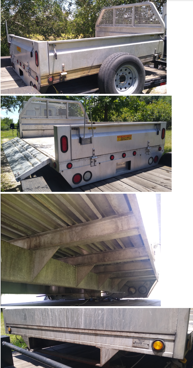

Re: Mounting an aluminum truck bed
Lots of simple options. Stock beds often use a long bolt through bed to a captured nut inside the frame or beyond the frame. Long U-bolts are reliable too. You’re not providing a lot of information or decent photos to provide any better ideas. Sure thing, cj. Adding some pictures of the frame. Are ...
Hope everyone is doing well! I'm not familiar with mounting these and I'm looking for ideas. The outer measurements on the bed c-channel is 38" and outer measurements on the rectangular tube frame is 42" for 2003 Ram 2500.
- Screenshot from 2026-07-12 13-23-26.png (1.21 MiB) Viewed 7746 times
