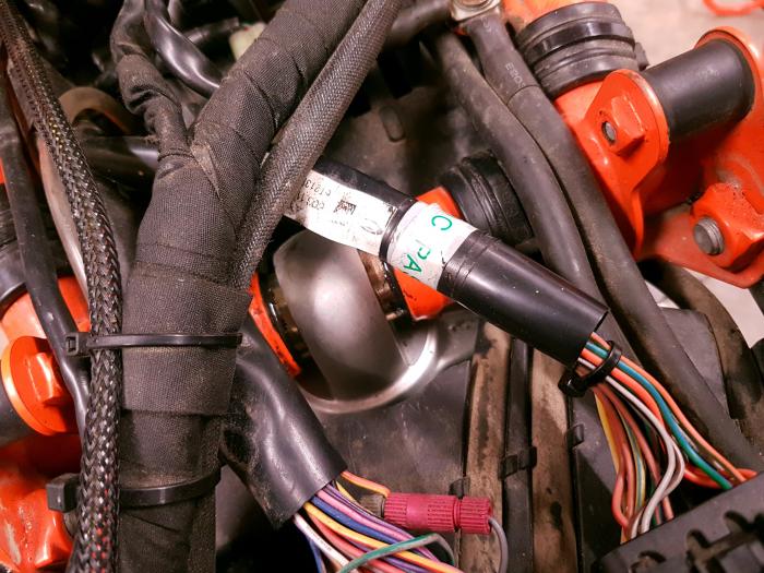

Re: Motorcycle frame (modern!)
And yes that is a PCV lead. To be honest all it did was whack up my fuel consumption, so I reverted to a zero-map, until I next have the tank off, when I'll remove it and eBay I think. Though Dyno-jet UK did offer to dyno/tune it FOC if I took it to them.
