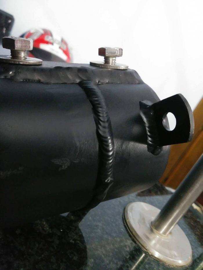

Re: Little help figuring out my restarts on TIG aluminium
Ahh, sorry.. small illusion there.. I flipped the piece around, that's why it looks like there's uphill and downhill.. but It is possible that I flipped the piece around and went downhill the other way :? I do try to keep the torch angle but didn't even think of counting how many dips I was doing. I...
Thanks guys! Hah! I didn't think off that! I should've just not added the extra dabs when I ended each run.. I was worried I'd blow a hole if I didn't put the dabs when I'd go do the restarts.... CJ, Next time I will try to increase the torch angle like you mentioned and see if I get an improvement!...
Hello everyone! I am working on an aluminium thin wall pipe oil catch can of about 2mm thick (under 3/32" thick) and I am having an issue with my restarts... Since I add a dab or two at the "end" of a bead to avoid the crater cracks the "end" looks bigger than the rest of th...
