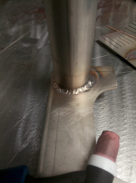

Thanks for all your feedback. I finally got my machine, a AC/DC 200A, a cheap Chinese import, 110/230V, 450€. As my project is on boat related, I got a small disposable bottle, it only lasts 40min but, it's ok. Picture of the bench at home, the machine is fairly compact Also a picture my very first ...

Just made my first TIG welds today:
2mm thick tube on 4mm plate.
Definitely harder but will practice more!
