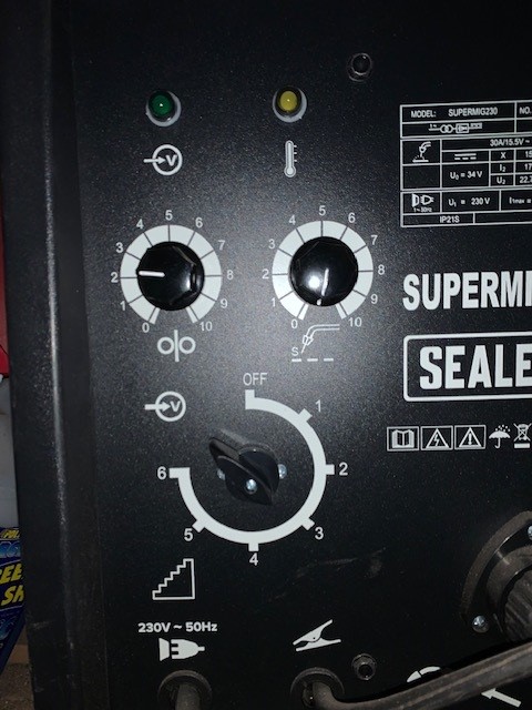

Mig Welder Settings
Hi all,
I have a Sealy Supermig 230 and wondered how to work out what the voltage settings are with eack individual 'click' of the dial.
Thanks
Spragz
Thanks
Spragz
- Sealey Mig.jpg (83.16 KiB) Viewed 5899 times

I have managed to run some tests and now have a general idea what IPM im getting on each setting but the volts/power has me stumped. is it simply a case of trial and error? Generally yes, you figure out the IPM that will deposit the amount of metal you want, and the voltage is tweaked to provide th...

Thanks guys, apologies for the delay in replying, blame covid. I have been well enough today to have another go with my mig welder, I'm hoping you'll agree that its an improvement. There was a hint of bacon frying :D One thing I'm struggling with is figuring out what power I'm running at as my welde...
