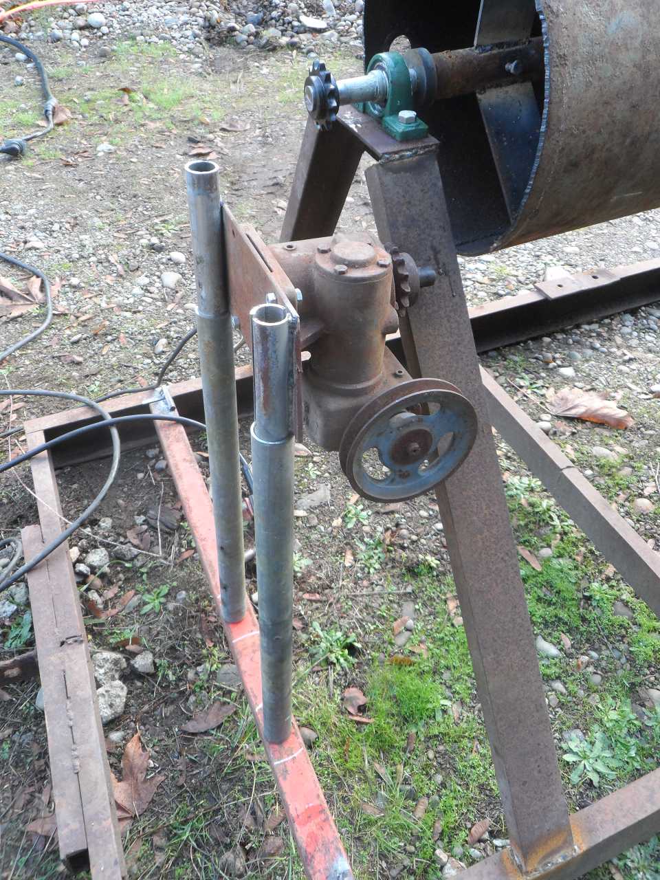

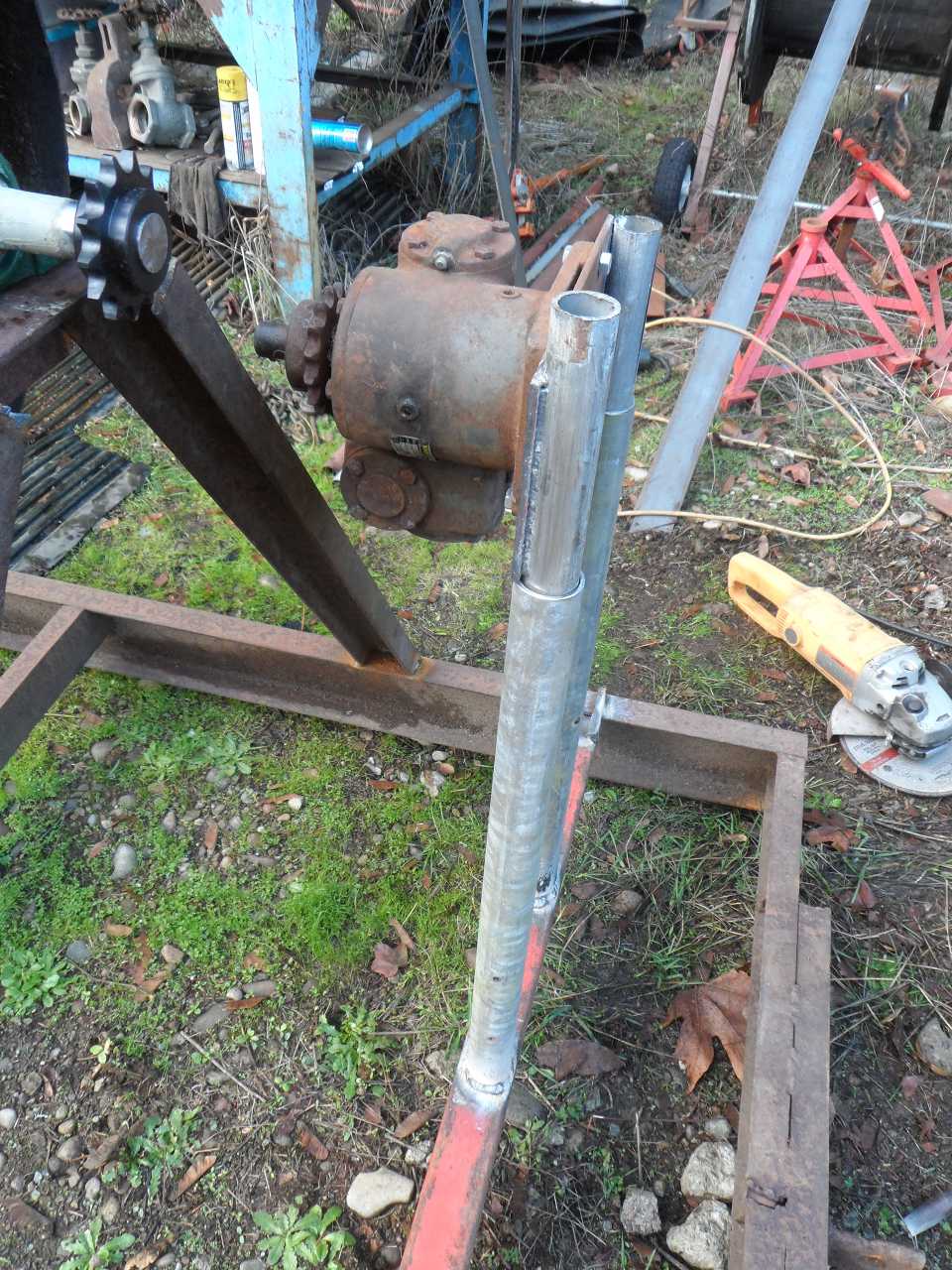

Finally managed to round up some sprockets and chain for coupling the drive box to the drum shaft. The chain is #50 roller chain and the sprocket for the drum shaft will be a 13 tooth with a one inch ID that will just be welded to the shaft, the sprocket I'll be putting on the gearbox is an eighteen...

Here is a pic showing the gearbox and adjusting slide sitting in place to be welded.
Another pic with them tacked in.
Another pic with some supports added.
- Gearbox and slide waiting to be welded
- slideinplace.JPG (215.18 KiB) Viewed 2740 times
- slidewelded.JPG (221.43 KiB) Viewed 2740 times
- driveslidewelded.JPG (204.38 KiB) Viewed 2740 times

Well it's been a while since I updated this project, so yesterday I managed to get a little work done on it :) I had a scrap of 1/8th inch flat bar laying around so last week I drilled some holes in it and made a gearbox mount. driveplate.JPG After that I found some 1-1/4 tubing and welded that to t...
