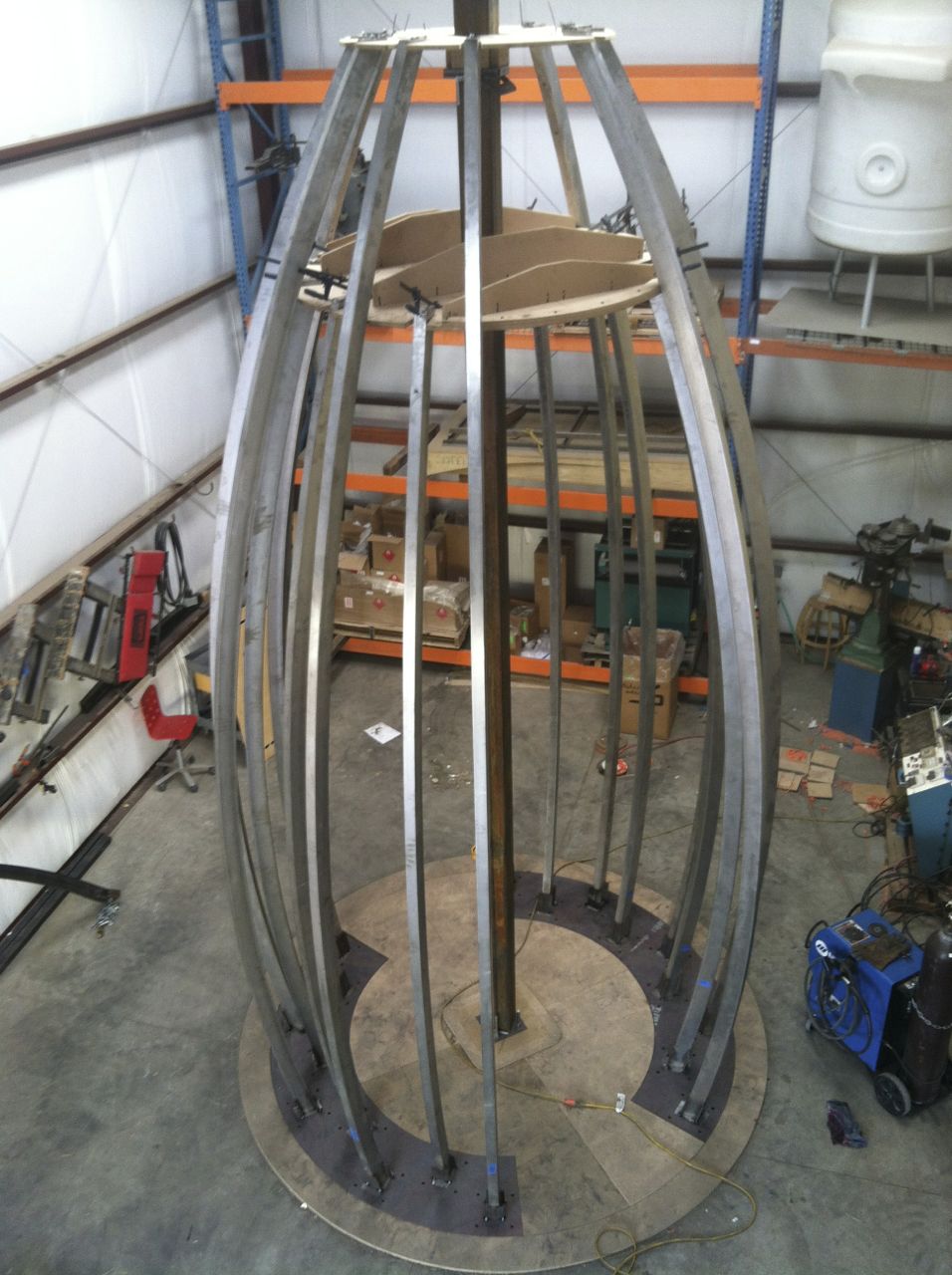

Re: Art sculpture
Ehart4130. What do you use to keep the carbon steel dust from giving you difficulties with the stainless steel materials and welds? One advantage is your location being Arizona, a dry climate with a low humidity, but even the iron with morning dew will start pitting. Tanks. Alexa So far all I we ha...

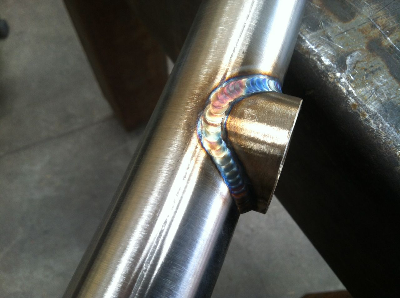

Re: Art sculpture
Hahah! I bet with some practice you can make some good ones!CraigLam wrote:Ehart, the only way for me to get perfect SS welds like yours, is to have someone else do it.
Can't wait to see it finished.
Elliot

Re: Art sculpture
Here are some of the stainless steel TIG welds that are going on the sculpture.
TIG is totally my preferred way to weld stainless steel
Elliot
- IMG_0715.jpg (170.52 KiB) Viewed 2896 times
- IMG_0716.jpg (134.58 KiB) Viewed 2896 times

Re: Art sculpture
Here is some more progress of the art piece. The outer uprights are 18' tall...
- IMG_0709.jpg (167.99 KiB) Viewed 2936 times

Art sculpture
Here are a few pictures of this stainless steel art sculpture I am working on at work. I have been getting some great feedback from others on some of the stainless steel MIG I did to get this going. I will post more pictures as it comes along... Here you can see this huge jig I made to secure it for...
