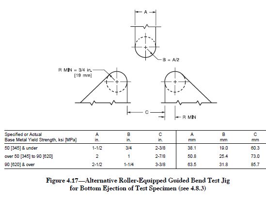

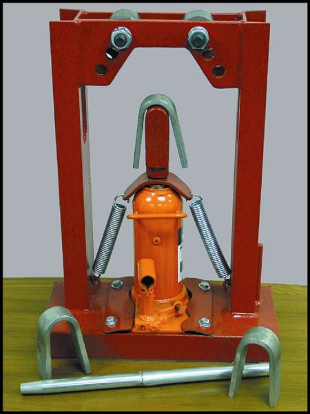

- Sat Mar 21, 2020 1:21 pm
- Topic: Weld tester
- Replies: 9
Re: Weld tester
Here's some info from AWS D1.1 and a simplistic example of one.
- guided bend test jig1.JPG (65.19 KiB) Viewed 3728 times
- guided bend test jig2.JPG (33.3 KiB) Viewed 3728 times
- guided bend test jig3.JPG (34.99 KiB) Viewed 3728 times
- Coupon bender guided bend test.jpg (38.73 KiB) Viewed 3728 times
