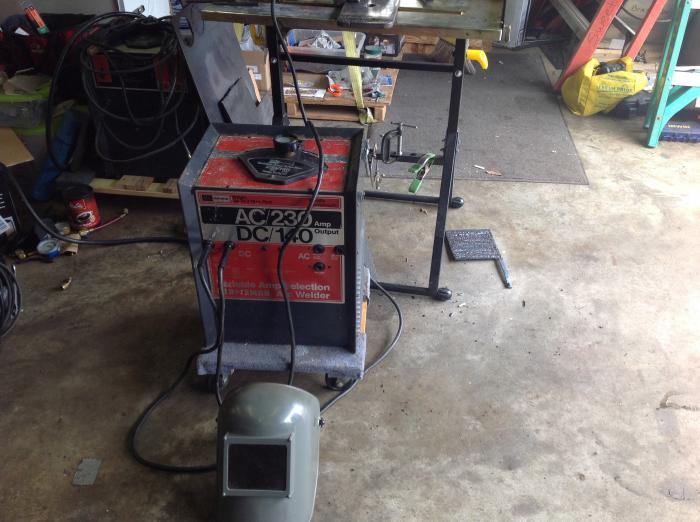

Re: Critiques needed on 7014 beads ona practice plate
[quote="Aleksi86"][quote="Aleksi86"][quote="Hvacr"] Aleksi86, thank you for your advice and for looking at the pics. Your welds look great, something to aspire to! I too noticed the puddle is easier for me to see with a fixed shade 10 lens the auto-darkening helmet i ha...
Thanks for looking AKweldshop, your observations seem to be the consensus too. I want to go from A to Z without going thru B,C,D,.......etc.AKweldshop wrote:Too cold and too fast of travel.
I agree with Dave...more practice. You are moving too fast on some beads in the middle of the plate. Look at the shape of the bead you are leaving behind. when you see a bead with sharp peaks or points like that, it means you are moving too fast. But don't worry it is just practice that you need. F...
[quote="MinnesotaDave"]I would increase your amps, start doing half overlap beads until you can make everything straight and level - pretend you are doing a buildup of a worn part to be machined flat - that would mean even fill without holes or valleys. Once you've burned enough rods for t...
Ok, well i have improved, i can almost weld a straight line. The pics are of 1/8" 7014 rod on a 3/16" plate DCEP AT 132 to 138 amps approx. the pic makes the beads look more convex than they are but given the side view pic with the rod piece to show a height comparison, are the beads too h...
