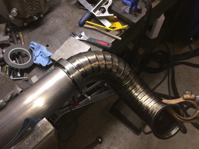

Re: 321 to mild on a turbo manifold
Ahhhhh yes, that's the missing link in my thinking - the heatsink. Thank you Arno, makes perfect sense now. My wastegate is on a takeoff from the turbine housing, fairly remote, and it's a big ole V60. They're not watercooled but it's in a good spot in terms of cooling https://i.imgur.com/O8mviev.pn...
Schedule 10 1.5 yeah so .1" wall. It's not so much about the amount of chrome but the Cb of 347 to stabilize the joint and prevent carbide precip (in my mind anyway).
Never heard of that and I don't doubt it works but I'm specifically after extreme temperature resiliency (hence using 321+347). Even Burns who makes pro manifolds says to use 309 on the header flange, and I'm sure it's fine as that joint isn't as critical as the tubing butt joints or the collector b...
Hey guys, I'm working on a new turbo manifold for my car and I'm doing the runners out of 321. Experienced turbo racers told me to use a mild head flange for expansion and to weld to it with 309. Burns seems to agree but I was wondering what you folks thought? I know 309 is meant to weld 300 to mild...
