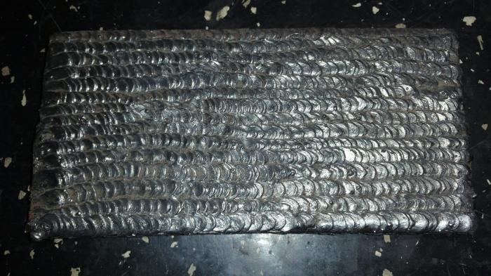

Here's a pad of beads l did last night. I have covered 3 coupons this size both sides in 2 sessions. I am making use of seat time. Most of these were 7014 then l took the plunge and tried some 7018, a little more difficult to initiate an arc but I'll get it . I need to work on filling the crater at the end of my beads and l know they're not stacked perfectly but here for your viewing pleasure..........

I tried switching direction, didn't work well so l stopped. I will spens a lot of time working with my non dominant hand next time as this is something that must be done. The beads appear to switch direction on this pad because I started in the center of a warped plate to see if l could pull it flat, worked quite well. There are also tie-ins about every third bead, I'm burning every rod down to about 1 1/2 inch. Other students are dropping rods that aren't long enough to make a full pass. I figure tie-ins are part of the process so I better practice them

Looking real good! Don't worry about trying to do everything the first week. One step at a time.sedanman wrote:I tried switching direction, didn't work well so l stopped. I will spens a lot of time working with my non dominant hand next time as this is something that must be done. The beads appear to switch direction on this pad because I started in the center of a warped plate to see if l could pull it flat, worked quite well. There are also tie-ins about every third bead, I'm burning every rod down to about 1 1/2 inch. Other students are dropping rods that aren't long enough to make a full pass. I figure tie-ins are part of the process so I better practice them
When you end the bead and still have plenty of rod left (especially 7018), take the rod out of the stinger and tap the end to remove the excess flux. It helps with restart of the rod and you are less likely to have scorch marks on the work.
(Honestly, your first pad looks better than my first.)
