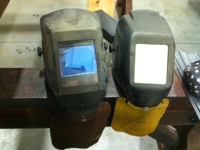

You know that triangle burn you can sometimes get on the bottom of your neck or top of your chest? I got around it this way.
I had an old set of leathers that were worn out more from sitting around. So I cut a rectangle out and got some velcro tape on the bottom edge of the helmet. I cut it the width of bottom edge about 6 or 7 inches long. Then I cut it about 8" wide so it hangs about 6 to 7" down.
I put one piece of velcro on the leather and the other half of the velcro on the helmet. When that gets worn out of falls apart its easy enough to take it off and replace it. You could install snaps on the helmet and use snaps on the leather. I may do that with mine.

I use the leather bibs on my helmets when I don't want to get chest/neck burn. They are the clip on type not Velcro.

I use an Optrel E680 helmet and they make a bib that fit to the bottom edge of the helmet with what looks like an older style windshield rubber
I used to suffer from chest burn on a regular basis , but this has eliminated it all together...

Our job offers us welders the chin flap to protect our chest from that burn since alot of work is done kneeling and bent over exposing the chest alot. Works great. Ours are held on with velcro as well. Have also seen some people that are outside contractors cut up an old welding sleeve and use part of that with a little tape on the inside for the same purpose. Just watch it while welding overhead alot.

I bought the Tillman 567's (velcro version) earlier.
I don't know if mine had been on the shelf too long or what, but when I removed the paper backing to stick the strip on, all the glue came with it. Bout to fix that right meow.
Mines going on the top, I haven't had much trouble up front.
But when I get the spare mulah, gonna get this. http://www.usaweld.com/Optrel-Leather-C ... /k5931.htm

I cut 2 rectangles about 5” x 11” from a soft leather off cut and stuck them on the rim of both my helmets with carpet adhesive. Makes me look like TXSVIKING or Kevin Carron - I’m waiting to see if it will help me to weld like them!
