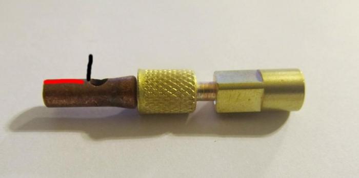

So in another thread the topic turned to the possibility of a burned power cable , and that reminded me that many years ago I had a tig torch that leaked so I removed the outer material to find a crack in the water line in the neck, enjoy.

In that thread there was mention of some type of fused connection, either wire braid or what sounded like a fuse. Possibly not, but I was wondering if you could take a pic showing the electrical side and what that looks like behind the water lines? Or is that just the gas?
I've never been quite clear on how the electrical and gas get to the torch and/if if the electrical travels on the outside of the gas portion. :oops:

Water comes in through the the 1/4"-20 threaded fitting.
Water leaves the torch through one of the barb fittings.
Shielding gas enters the torch through the other remaining barb fittings.

Ok, but you didn't actually answer what I was confused about.
Is the arc initiated through the gas? Doesn't there need to be some type of electrical connection for the arc? :?

Oh, the electricity travels through the copper wire conductor inside the water hose that goes to the threaded fitting. The arc only emanates from the tungsten.

Electricity flows through the tubing walls.
Edit; so when you over heat a torch it often melts out the solder between the tubing and one of the ends, leaving you with a poor connection.

Poland308 wrote:Edit; so when you over heat a torch it often melts out the solder between the tubing and one of the ends, leaving you with a poor connection.
Couldn't this be re-soldered to repair it? Doesn't the braided copper connect to the threaded fitting which Oscar points out, then through the fitting to the torch head, right?
As a DIY type person I as originally thinking to check all connections for connectivity and/or clean/repair them.
Interesting video Oscar posted. Seems even on a gas hose it would be possible to snip the hose and re-attach it to the threaded fitting, or is that a difficult procedure?
Sorry for some many Qs, just trying to understand if in Mark's case it's possible to repair his torch? I realize we don't actually know what his problem is, but Richard shows what his is.
In regard to my question to Richard, I was originally thinking that current traveled up copper braid and attached to the threaded portion, but wanted to see how the threaded portion connected to the torch head. From both of your description that seems to be the case. Is that the segment that fails, as Josh mentions? (i.e., between the threaded portion and the torch head)

Possible but most of those torches have rubber overmolded you don’t have to remold a new rubber handle
Plus a new torch head is probably less than 100 bucks most people charge 100 bucks an hour for repair work

TraditionalToolworks wrote:Richard,
Here is the cable side connection for a series 2 torch, the power line is inserted up to the black line and then the connection is crimped along the red line, at least that's what we used to do
Now that I look at the torch again, it is not for the cable connection I just posted, but I believe you get the general idea of the workings :)

Thanks Richard, that does help. It looks solid though once it gets to the threaded connector as that's all conductive up to the torch head best I can tell, through the copper.
Is the weak link where the copper braid connects/crimps on the threaded connector? (your last pic)
Well I've had faults there, and at the machine end and in between so... :?:
