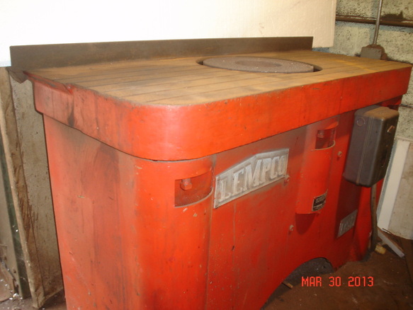

I was sitting here thinking about how to resurface your manifold when you get it welded. It will need to be very flat before you install it or you will put a lot of stress into the thing and likely break it again.
I have a flywheel grinder at work which has a big flat table and then a probably 13 or 14 in face wheel which you can adjust the height to match the table. In that way you slide the flywheel using your hands over the wheel and very slowly dress the surface. I wonder if something like that wouldn't work on the manifold. If you have an engine shop nearby you might see if they can do something similar to grind the mating surface when you are ready.

I don't mean a surface grinder per se. I have several of those also. The thing I'm talking about, at least the one that I have, think of it like this. Imagine a table at about countertop height with grooves in it all ground and Polished for the purpose of having Parts slide on top of it. It's about four and a half feet wide and let's say 20in deep. In the center of the table there is a hole and within that hole there is a grinding wheel which is self-balancing, with a downdraft fan and is adjustable for height so it matches perfectly to the table itself. So you slide a part around on the table and whatever goes over the wheel gets dusted ever-so-slightly. In the case of a manifold like your V8, you could have the two outside Runners still on the table while just touching the center two with the wheel or you could have three on the table and the end one on the Wheel. Not sure if that makes sense. But you're using the mating surface of the manifold as the reference to the table and whatever High spot or low spot gets hit by the wheel and made Flat.

I believe Van Norman made a resurfacing grinder like that. A guy in the Albany, NY area had one for sale that I came close to buying, but didn't. I'm long since out of space due to my machine collecting habit. Imagine the game tetris with all the blocks shaped like lathes, mills, grinders, shapers, saws and welders. That is my shop. Now I am trying to determine how to fit a J&L turret lathe.
Mine is a "Lempco Model DSM Surface Grinder". Without the brand and model, you can search surface grinder till you're blue in the face and not find a pic. Here's a pic of what mine looks like, except mine is mostly used as work table and all covered up with stuff for adjacent machines. Given your statement about your shop, you probably know what I mean.
