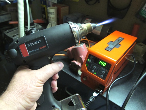

- Welding nozzle.JPG (79.49 KiB) Viewed 2938 times

No, they won't replace all of my other welders and I have ten in total. Miller is my favorite.
Where they do shine, is welding mild steel. It replaces my oxy-acetylene torch and its much less expensive to operate.

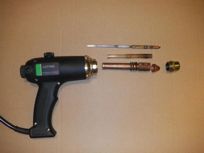

The basic concept of how they work is pretty simple, once you've dismantled the beast and had a look inside.
Very similar to a kettle that boils water. It all starts with an internal arc, between the nozzle and cathode.
The heat from this arc travels down a copper tube into the 3oz water storage area that contains mineral wool. (I believe)
When the water heats up, the steam exits thru the nozzle as the unit is sealed. This steam has to pass thru the arc.
Plasma is the fourth state of matter. (solid, liquid, gas, super-heated gas=plasma)
The 3oz of water gets you 20 minutes of welding time. It is hotter than acetylene and burns clean.
I truly like this torch for its simplicity and the fact that it works well on water, (or water&alcohol for more heat.)
The fact that it gets so hot is probably its weakness as you can easily cook some metals. (14,400 degrees)
If you have learned how to gas weld, you can control that heat easily by moving the torch closer or farther away from your work piece.
Its not a welder for everyone, but it does have its place in the welding community.
It can be finicky to get going, if you are not familiar with it, but it does work well.

- 1 MultiPlaz.JPG (28.6 KiB) Viewed 2893 times

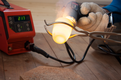

- Multiplaz.jpg (146.01 KiB) Viewed 2885 times

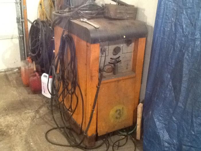

By the way, 500 lbs? My favorite welders start about 900 lbs - and yes, it was made in the USA. Some great welders are made here and elsewhere in the world as well.
900 lbs of 1963 awesomeness right here
- image.jpg (52.81 KiB) Viewed 2062 times
GreinTime
- GreinTime
Location:Pittsburgh, PA
Two brothers who's weld shop I frequent when I am back in Pittsburgh have an ooolllllllldddd Linde UFF-305 (not exact on model number, its normally the middle of the night when I'm there, and its been a week or two
) We were talking about the limitations of the Dialarc 250HF on low amp starts and they both point over in the corner and go "Check out that old green battleaxe." Needless to say, the starting amps on the HIGH range were much, much lower than the Miller.

it kind of freaked me out. I didn't believe it. I'm not affiliated with MultiPlaz, nor do I ever plan on selling them.
My friend Garnet bought one, and he insisted that I come over and try it. I tried it and really liked it.
When someone asked about it on this forum, I told them what I saw.
Then, Otto started with his rant and I decided to buy one for myself.
http://forum.weldingtipsandtricks.com/v ... plaz#p8886
The torch is quite amazing and it outperforms my oxy-acetylene which I tend to use the most. It's not the perfect welder, and it has it's shortcomings, but I like it just the same. Every welder that I own has something that it does well and other things that it can't do at all.
