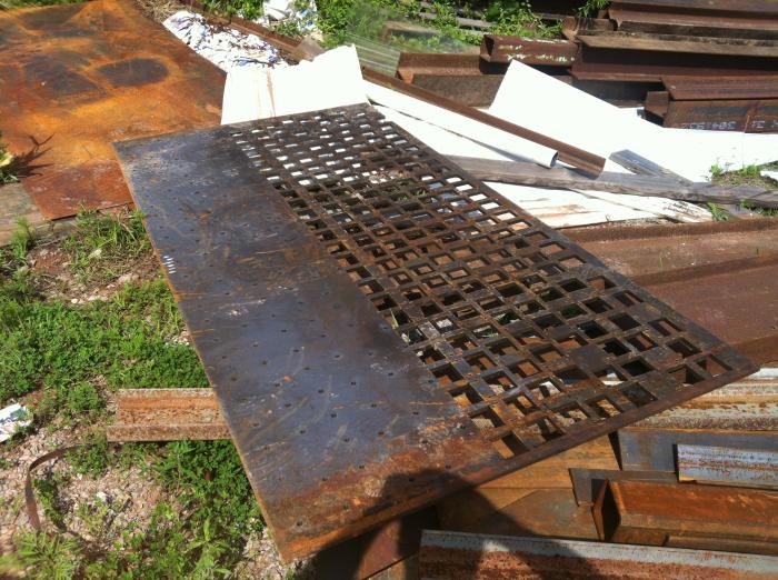

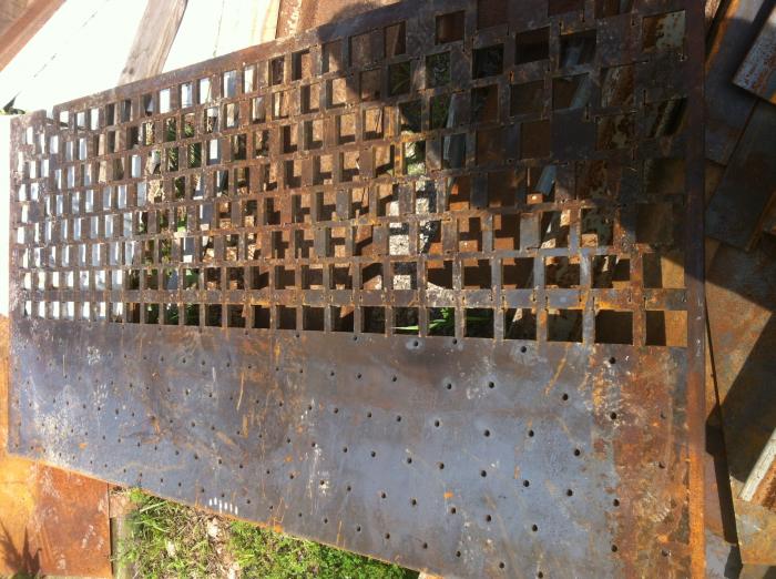

Ok, I made it back down to the scrap yard at the last minute yesterday to get some pics of that 3/4" plate.. Please tell me what you all think, if I should use it for a table top or not.

- IMG_1117[1].JPG (73.02 KiB) Viewed 2401 times
- Possible table top, 600lbs
- IMG_1115[1].JPG (83.71 KiB) Viewed 2401 times
Not sure about the cutout side, may need lots of support. Looks like it's only about 20-30% left. Might work for a cutting table too!
Glen
Carl,
If it's still roughly flat, I'd take it in a heartbeat. Ideally, the whole sheet, or half crosswise, for a mix of open space and nearly solid surface, and build a tough-ass stand for it. If you have the budget, have it planchard-ground for near dead-flat, and use small stitches to attach it to whatever base you build to minimize distortion.
I'd love to have that slab for a table. No more tacking half-clamps. Tons of places to either fit a C-clamp on the open half, or bolt stuff down on the other half.

That thing is 5x7 and my current table is 3x5 so a lot of it is going to get cut away (thank GOD!). My only concern is that my current table has a 1/8" flat surface (complete). I guess I will have to "cut" it wherever the squares are on the new piece just to have places to clamp to.
As for being flat, it is flat or flat enough for what I am doing or will ever do (I think). I am not a professional and this merely a hobby at this point.

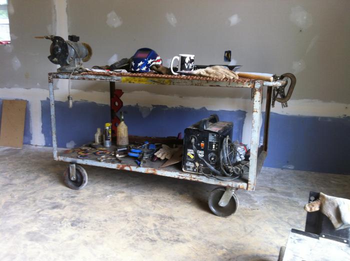

Have you seen my "new" welding cart that I bought from the scrap yard? Here is another pic... I love advice so keep it coming, I am picking up that new top on the 1st...
CrazyCarl
HW!

Yeah, Carl, I saw that cart.
Didn't you buy that "by the pound"? That was a sweet deal, with working castors!

Looks like a awesome table top to me. Looks like a plasma table drop to me. It might not be as flat as you would like but for what you need it will be fine. I agree with everyone, having those squares will be beneficial in many things. I might have to steal some ideas from that drop.

Yeah I know I believe it will be a great top but extremely heavy. I think once I get it cut down to size and tacked on the table it will still be around 400lb... I am going to reinforce the legs and the center of the table.
As for the cart, I got it for .30 a pound but the casters were NOT included. The local scrap yard here has 2 parts, they have one that is called L&L (the scrap part) and L&S where they take odd stuff and resell it.. I got the castors complete for 60, he wanted 20 a piece and I talked him down to 15 as the fronts are plastic and the rears are solid steel. They are 8" and from what I saw on the net they should be able to handle roughly 800lbs... so I should be OK.
CrazyCarl
