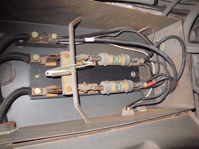

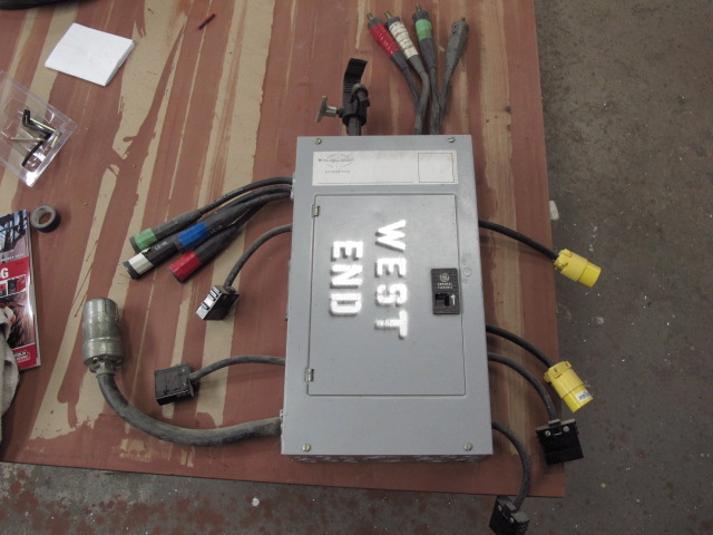

Here's what I did for my power. Note it's all "temporary" so I can move it to wherever I need it. The 3 phase machines are all hard wired into a phase shifter.
I tied in four #2 welding cable pigtails to one of our main fuse boxes. From there it runs about 25" and twofers (splits) into 2 diferent 220 4 wire 150 amp distribution boxes. I also have two 50' 6/4 SO extension cords or can use welding cable for longer power distances. Everything uses the same type plug so it is all interchangable. If I need to go on a job site, I can pack everything up and tie into any power supply with the heavy duty alligator clips that adapt into LC-10 connectors. If I get fired or move, I can also pack up all my power supplies since they aren't hard wired into the wall. That's the nicest thing about it being temporary. The hard part is the cost of all the connectors and adaptors, but I did it over time and tried to find whatever I could on sale or closeout.
adapters x cable and alligator clip
distribution box
distribution box
pigtails from main fuse box

Thanks for all information, photos, and effort. Your setup is very intriguing. I'm not yet totally clear how it all works together, but I've only looked it over in the last few minutes. I'll study it some more, and show it to a friend who is more knowledgeable about electricity--maybe he can clarify some of the details. Give me some time--I'll ask questions later if I still have any. Thanks again.
