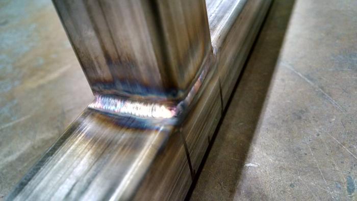

- 1" x 1" x .065" wall 304L
- IMG_20150908_221853329_HDR.jpg (34.24 KiB) Viewed 2983 times
This is going to be for a brewery that my brother in law and I are planning on opening. Right now we have a stand made out of wood and are working out of his garage. We hope to be in business in the spring in a commercial location. 1000 lbs of weight is really the worst case scenario. This would be when we have 3 - 55 gallon SS drums on it. One empty, one with 150lbs grain and 75 gallons of water between two barrels. This water is no hotter than 160 degrees. The boiler water would be no more than 45 gallons or 375 lbs. At this point in the process its more like 500 lbs of weight.

When I read "brewery" and "stainless" I assumed you wanted to make sanitary welds for piping, which is a TIG application. Upon reading again and considering further, it occurs to me you'd >prefer< for this rack to be stainless, but it could be mild steel (since the rack you're working from now is wood).
If you consider using mild steel there are a number of "pros" and I think a smaller number of "cons". Mild steel is cheaper. You could use the MIG process, which is easier to learn- a shorter learning curve means you're more likely to meet your Spring deadline, and you and your brother are likely to be very busy during this time. You'd have to paint it (a "con") but in daily brewing operations, cleanup would be about the same, I'm thinking: a wash down with soapy water, just like with stainless.
Guys, check me on this one as it relates to MIG: Another reason to use mild steel is that stainless requires shielding gas on both sides of the weld: in your square tube application, you'd need shielding gas on the outside of the tube, and shielding gas or flux (called Solar B) on the inside of the tube. The coverage inside the tube is to prevent "sugaring", or oxidation of the weld. The requirement to back purge may be a complication you want to avoid, for the sake of the time investment.
Your first post asked about how to test a weld: first, practice practice practice. Watch all of Jody's videos on MIG, if you choose to go that way. One method of destructive testing is make a test weld on scrap material, then beat it a sledge hammer and try to break it. When you think you're far enough along, cut and etch a weld, like in this video

Stainless steel does need a back purge in a lot of applications but I don't see this as being one of them. These are not sanitary welds as in process lines for food service. The only beer that comes in contact with these welds will be spilt. Sugaring on the inside of the square tubing here should have little ill effect. It's always better to purge as it offers the benefit of keeping oxidation at bay, but not always 100% necessary.
Just my opinion, I would weld these all day without a back purge.

Get at least an 80 cu ft bottle. The bigger a bottle you get the happier you will be. Don't panic when you see the price of your first bottle but get one based off of how much it's going to cost you to refill. If you make sure you shut off your bottle if you aren't going to use it and leak check your hoses even a small bottle will do a lot of welding. If you need to purge then consider a second bottle and flow meter.
Like others have said, no need to back purge the inside of the tubing frame....Since your doing brewery stuff, if your plans are to move on to the piping, then a back purge is required. Id suggest a dual flow meter at that point (I use Harris Model#356) and a larger bottle I use a 156lb bottle on my small cart that I tote around the building, otherwise we have the large 336 in the shop. FWIW- Solar flux isn't approved for use in a food application where it has direct contact.
Sanitary welding is a whole different story, you'll need a TIG, patience and some skill to pull it off correctly. If your plans involve your brewing turning into something larger, Id suggest getting a TIG set-up if your going to purchase a welder. Get lots of practice and shoot for learning how to do your own piping, the welding is the easy part, the fitting and cleanliness required is not. Sanitary welding and pipe/pipe fitting doesn't come cheap, and can take some time to do it right but will save you a TON if you can weld fittings into your own pots and run some basic piping.
