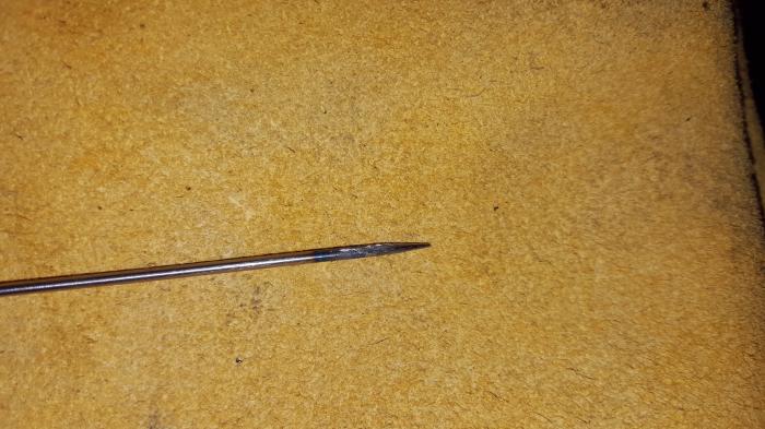

I upped the Argon to 20 SCFH and tested that there was gas coming out during and post and tried it once more. It was a huge difference! I was able to do several beads without an issue. It was very quiet, no sputtering. I did have to regrind once but that was probably due to dipping it in.
Thanks for your help. Felt like I actually got somewhere tonight.
Paul
Here's some pics.
- Bottom half was with filler rod
- 20150929_184900.jpg (43.9 KiB) Viewed 1341 times
- Reground, but is blue color below tip ok?
- 20150929_182137.jpg (49.55 KiB) Viewed 1341 times
- Is this tip contaminated?
- 20150929_183241.jpg (24.37 KiB) Viewed 1341 times
- No filler rod
- 20150929_183217.jpg (46.97 KiB) Viewed 1341 times
Paul...the pics of the beads with the orange residue is shield gas problem. Glad you found the problem. Try to back down your flow rate a bit as 20cfh sounds a bit high. I usually go 15 or so but gauges vary. Now go watch Jodys vids over and over until you can repeat the text verbatim and you will be on your way. Enjoy the learning process as you will find yourself coming back to the basics all the time. I'm glad you got it figured out, I'm more glad that you came here and asked questions. There are some really great people hangin around this site. Please keep us updated on your progress....Jeff

Thanks southpaw. That manual is very helpful. I think I'm finally getting it. Watching Jody'so videos over and over helped. I can work for a while without having to regrind tungsten. I have made a few beads I'm proud of. Ones that actually look like I knew what I was doing. My next problem is fitting up my pieces. I think I need to invest in a decent saw.

I seem to get good results on steel with 15 CF on a #7 cup , looks like you've got a smaller cup and 20CF is maybe too much , try laying a very short bead at 10 CF , 15 CF then 20 CF and see what happens. Also, small adjustments in torch angle sometimes have an effect on gas covering the arc good, or, causing turbulence that draws in air from behind . As for the flap discs, I use them too, but sometimes I wonder if any of the Alum oxide gets embedded in the material, even though it's steel i'm sanding. SS wire wheel brush might be better ??? idk . As for filler rod, I always twist as I pull it thru a cloth with acetone. There is always black gunk . If you make a mess, don't get discouraged. There is a learning curve with any skill...everyone admires TIG because it is hard , not easy . This is some of what I've picked up learning TIG this year. Good luck, have fun ! https://youtu.be/UNAAhwieNhU
