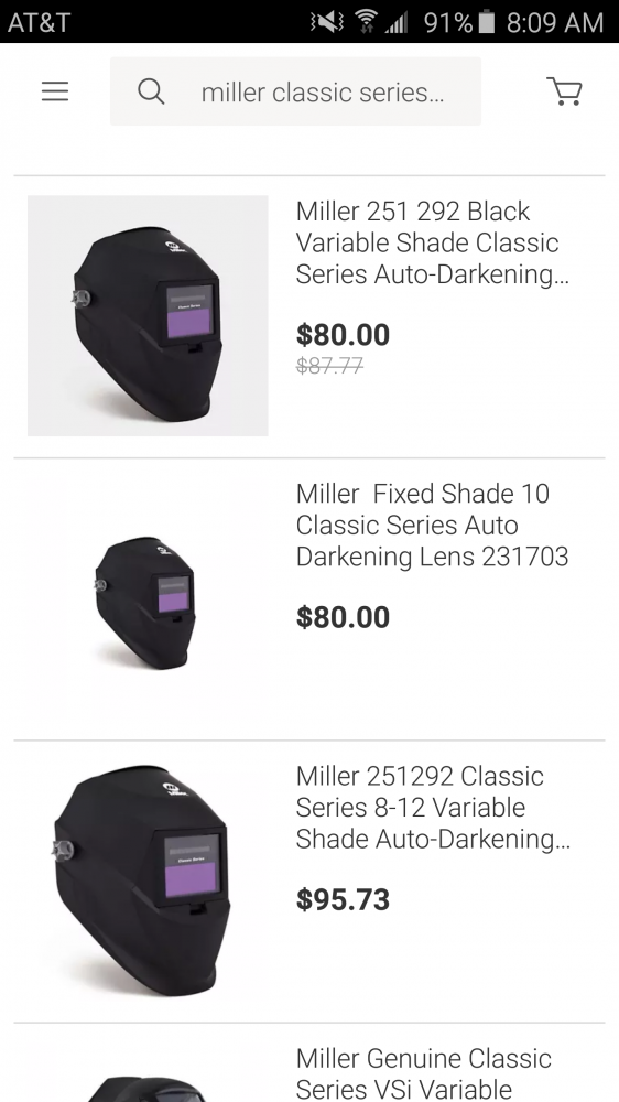

do yourself a favor and get a miller hood. if you can't afford a digital elite or one of the higher end models the classic series is usually priced around 70.00 on ebay. well worth that price. I've had my miller for four years and I've wore different hoods before but nothing comes close to the ease of use and quality a miller hood comes with.
EDIT:
here's a quick ebay search.. ok so it's 80.00 not 70.00.
- quick ebay search
- Screenshot_2016-02-25-08-09-36.png (313.69 KiB) Viewed 2740 times
Let's be honest I doubt it's the manufacturer or hood brand. This is just one of those times where you were unlucky. Either send it back for warranty or buy a new one.
