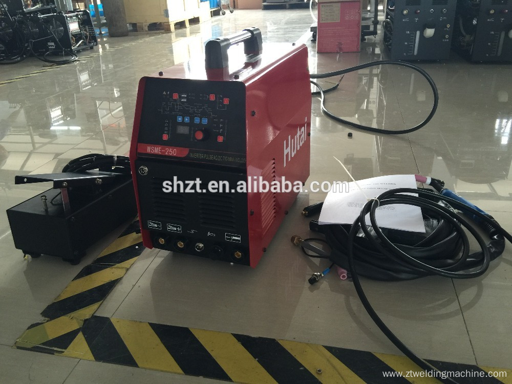

There are currently 2 Tig welders on my list... all comment´s would be welcome regarding these welders.
Popwel TIG200PACDC:
http://popwel.cn/products/TIG_Welding/2015/1104/37.html
Hutai WSME-200 AC-DC:
http://i.bosscdn.com/product/c7/d9/d2/e ... ize=20&p=9

The first one I have heard people speak good about. Its sold under many names.
Second looks like the newer Jasic digital version. No own experience on either though.

While I don't own precisely the model shown in the second photo, mine is probably a re-branded variation of it. Very happy. The best advice I can give is that whatever you buy, go for something that comes with proven support. As in, 'make a call, speak directly to a human being and get some answers' support.
I researched exhaustively online and in the end the choice came down to two similarly specified Chinese machines. One was around $800 cheaper but didn't boast any real support. The other machine came with a 5-year warranty and was sold by a dealer with a reputation for great customer service. I went for the more expensive machine.
Glad I did. I have had lots of questions and one minor issue since my purchase, and the dealer is always there to help me, no matter what the issue. That means a lot, especially when you are new to welding.

I don't know if I'm a bit late on this one however I have had a different branded version of the first one it's about 5 years old now and has done a lot of work and it welds as good as the kemppi and esabs I've used in the past

As above I might also be a bit late in posting a reply here. Anyway, for what it might be worth, I have a version of the first pic. Under the Jasic brand, for us in NZ to get anything that's not Chinese and still have the features that the Jasic has I would have to hand over double the amount I paid for the Jasic $1050.00NZ. (I'm just a hobby metalworker) I've mainly used the tig for welding aluminium and I think it dose a fine job, but then I've not used any other brand. I own 3 Jasic machines and haven't had trouble with any of them. What the machine you go with, enjoy the learning and don't let it get you down, Jodys fine videos are a great help and I've played them again an again and still pick up something from them.
