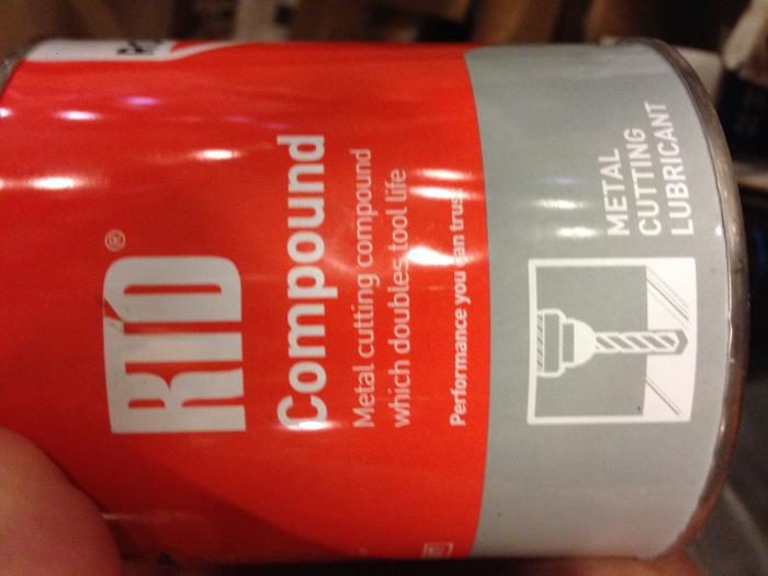

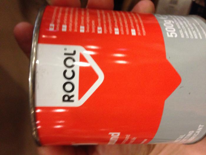

I made a stainless steel die (dice) but when I went to drill the holes in the mill some holes would just force the bit into the chuck and melt the bit. I used several speed settings and oil. Some holes drilled alright but some would not. Any suggestion would help.

Yep. Stainless likes very low RPMs with high pressure to make those ribbons peel off/up the bit. When you have the right pressure, you'll know by the ribbons peeling off silver. If they're straw-colored, your pressure is too high. If you get chips, your pressure is too low. If you can't get either, your bits are too cheap.
There is a cutting "wax" called Cut-Eeze, but I prefer Tap-Magic thread-cutting oil. The wax is far less expensive. I look forward to Josh's update on the cutting paste he mentioned.

I've been using some drill bits from enco, taping oil like Otto mentioned and 600-1400 rpm depending on the size of the drill bit ( starting small then increasing size)

When nothing else will do Plain Old Lard,even bacon drippings from breakfast pan.

135 ro 140 degree drill is good
four faceted drill points better
must be sharp and cool or it
will work harden the stainless
