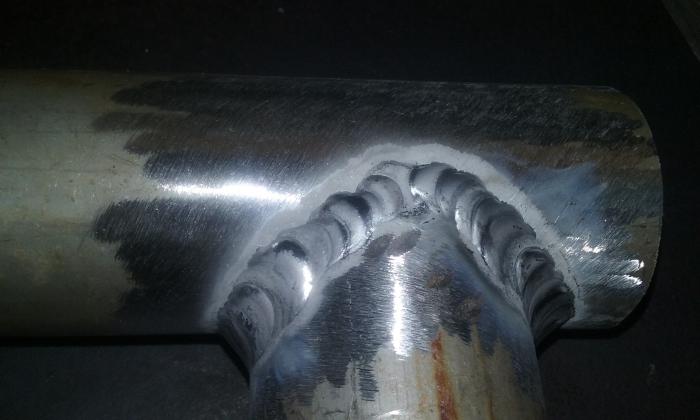

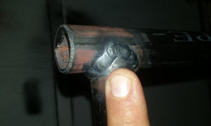

- Saddle weld on 3/4" gas pipe (125 amps).
- 20160527_110838.jpg (20.77 KiB) Viewed 3094 times
- Thin to thick.....1/16" to 1/8" aluminum (140 amps). I did blow through one of the sides of the thin tube on this weld.
- 20160527_110935.jpg (29.18 KiB) Viewed 3094 times

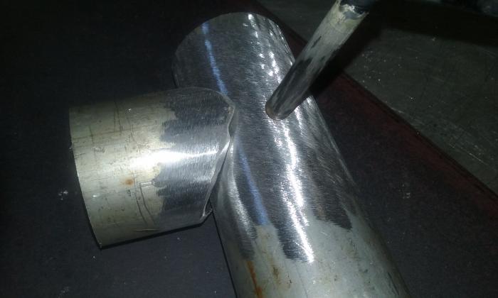

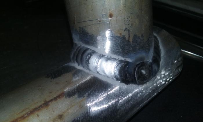

Here's images of some practice i did today (2" X .250" aluminum tubing saddle weld @ 225 amps). Bad fitup because my hole saw would only penetrate 1 3/8" of the tube so i had to turn it over in the notcher which resulted in a really nice gap on one side as evidenced by the crappy looking weld in that area.
That's my only experience with a welding job but i did more cutting and grinding than i did welding.
As a side note i do have an upcoming side job repairing an aluminum flatbed trailer @ $35/hr. No big deal cause nothing is over 1/4" thick and i have 250 amps at my disposal.
- Trying to get things to fitup.

- 20160527_161425.jpg (30.64 KiB) Viewed 3088 times
- You can see the bad fitup area here. I just didn't have enough finger extension to shove enough rod in to fill that gap. 3/32" 4043 rod. Yeah, i know that's no excuse but it is what it is for now.
- 20160527_161554.jpg (30.34 KiB) Viewed 3088 times
- 20160527_161657.jpg (35.48 KiB) Viewed 3088 times

Most jobs around here are for welding and fabricating and the only Tig welding jobs are production which means hurry up and get it done. There are high-end car chassis shops looking for talented Tiggers but they usually require experience. If you find a job welding/fabbing for someone else, they are still going to require a set amount of work to be done in an alotted time frame and it burns you out after time. I have a repair shop for off the wall stuff and very little of it entails tig. I get some stainless work from time to time that requires pretty welds but most repairs are mig work. IMO if you want to turn out high quality Tig work and not have someone standing on your neck all day, start your own business or find a company that will let you take your time and make things pretty. There is a member here, TamJeff, who does beautiful aluminum work on tuna towers and things of that nature for boats that, from what I gather, works for someone but they afford him the time to do things right and doing it right is when you get PAID. Just be aware that in a craftsmans mind, every weld should be pretty and the bozo hacks just don't care and still get paid.
PS...your welds look nice. The cerebral palsy on the one area of the saddle T is a textbook example of why good fitup is mandatory. You can sometimes laywire a bad fit on steel but no way on aluminum.

It looks like your are pretty good going around AL tube. You are in Georgia, head East or South for water. Lot of marine places have trouble finding AL TIG guys, boat lift outfits,tuna towers etc. One warning, there will be anodized involved, just another small learning curve and correct equipment.

I knew that I really needed 1/8" rod for that weld but I don't have any. I also was questioning that hole saw when I bought it the other day and I should have run a ruler into it before I unwrapped it. Turns out that this particular hole 2" saw is only 1 5/8" deep so it isn't suitable for notching tubing. Stick the mandrel into it and now I only get 1 3/8" depth of cut. When it was all said and done I was left with approximately 1/8" gap in that area. The arc force fed the puddle to the back of that gap which was 1/4" deep and i just ran out of finger length to shove that puppy in.
Ultimately I would like to own my own business and building tubular chassis is where my my mind seems to be heading. Good call on that one. I'd really like to build rock crawlers and race cars. (Can you say "steep learning curve"?)
I wasn't aware that there was much difference in welding annodized but I'm headed to youtube to see what I can find on that now.
