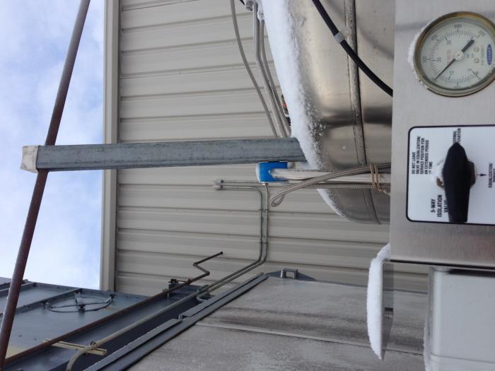

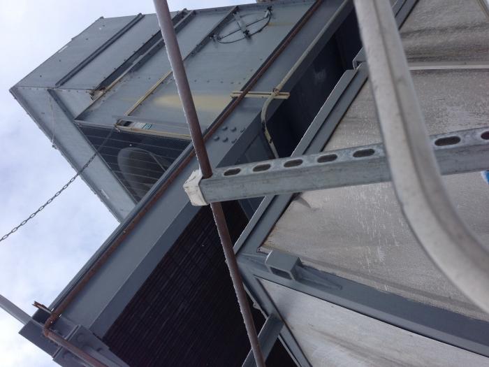

The line in the picture is a copper line ( crazy support ). It's the main line off a double tank set up that feeds a regulator station in a food plant. That line leaves the pic goes about 8 ft unsupported and is then tied to my ammonia condenser. Just a little vibration. No one else sees a problem.

I just realized... That piece of uni-strut the copper is sitting on is galvanized...
Triple-whammy! Metal on metal, dissimilar harness metal without padding, and copper on zinc in the equation.
"What the hell were you thinking" indeed!
Something tells me Praxair would shit to realize that uni-strut was welded (or just set directly on) to the vacuum-jacket of their customer station.
Agreed. Worst part is all the SS tube on the skid is welded nice and pretty. And they used a standard hardware store compression fittings for a couple of the copper joints.

Steve, could you inform me what's so bad about copper on galvy? I've not yet encountered this, and would like to know what to say when I do.

When water runs off the copper piping to a zinc surface it will react and corrode. Galvanic reaction I believe is the term...nathan wrote:This thread is giving me panic attacks.
