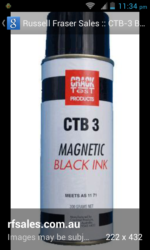

I'm down with the process, we use it. The magnetic medium comes in cans, the techies spray in on whilst powering on the magnet. Its got a fluid that dries leaving the black particles on a spray painted white background.
- uploadfromtaptalk1419942891940.png (205.28 KiB) Viewed 1088 times

I have never seen or used that...sounds neat. Is it permanent? Like maybe it dries in place? The dry powder method needs a clear spray to hold the powder in place if needed. I've also used hairspray. As soon as you fire up the carbon arc, it blows the powder away...LOLweldin mike 27 wrote:I'm down with the process, we use it. The magnetic medium comes in cans, the techies spray in on whilst powering on the magnet. Its got a fluid that dries leaving the black particles on a spray painted white background.
John Wright
Really? Thar's all we use here. The only time we use the dry powder is when we have to perform MT in hot surfaces.jwright650 wrote:I have never seen or used that...sounds neat. Is it permanent? Like maybe it dries in place? The dry powder method needs a clear spray to hold the powder in place if needed. I've also used hairspray. As soon as you fire up the carbon arc, it blows the powder away...LOLweldin mike 27 wrote:I'm down with the process, we use it. The magnetic medium comes in cans, the techies spray in on whilst powering on the magnet. Its got a fluid that dries leaving the black particles on a spray painted white background.
The particles are not permanent but the white contrast paint is.

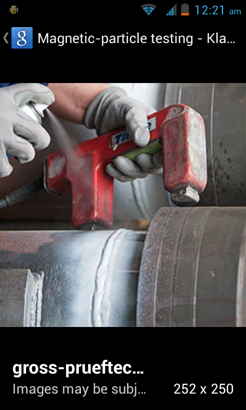

This is how we roll in AUS. And a wax pencil to mark out where any defects are. That is plenty permanent to repair anything.
- uploadfromtaptalk1419945784200.png (293.54 KiB) Viewed 1078 times

I like the use of the white for contrast...I have used PT(dye penetrant) developer as a contrasting background before.taz wrote:Really? Thar's all we use here. The only time we use the dry powder is when we have to perform MT in hot surfaces.jwright650 wrote:I have never seen or used that...sounds neat. Is it permanent? Like maybe it dries in place? The dry powder method needs a clear spray to hold the powder in place if needed. I've also used hairspray. As soon as you fire up the carbon arc, it blows the powder away...LOLweldin mike 27 wrote:I'm down with the process, we use it. The magnetic medium comes in cans, the techies spray in on whilst powering on the magnet. Its got a fluid that dries leaving the black particles on a spray painted white background.

Ahhhh.weldin mike 27 wrote:That white is actually paint. Not powder developer like dye pen.
