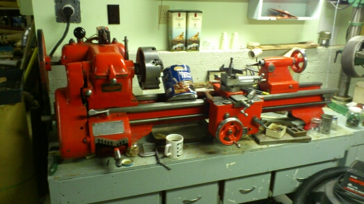

I have a older Clausing lathe that I inhereted from my father along with a Atlas shaper. I bought a midsize mill later on so there isn't much that can't be made.
- DSC_0223.jpg (144.14 KiB) Viewed 2516 times

I think I found a lathe! Going to see it this morning. It's a Logan 210. The guy that owns it said it came with the house he bought. It belonged to the original owner who built the house and it has been in the basement since the house was new and was the guys personal hobby lathe but he passed away and his wife sold the house and left the lathe. It looks to be in beautiful shape and comes with lots of tooling and a 3 jaw and 4 jaw chuck. He wants $700 but I think I can do better, he doesn't know anything about lathes and has never used it in the 25 years he has owned the house. Im'very excited!

Good deal. Isn't that a 10x24 inch lathe? Small but still useful. I find most all of my use of a lathe is small stuff so my 12x36 is fine. The other thing that helps sometimes is the size of the spindle bore so you can turn longer stuff that the capacity of the lathe. Mine has a spider and just over 1-1/2" spindle bore so I can cheat a little. Any first lathe is exciting. Good luck.exnailpounder wrote:I think I found a lathe! Going to see it this morning. It's a Logan 210. The guy that owns it said it came with the house he bought. It belonged to the original owner who built the house and it has been in the basement since the house was new and was the guys personal hobby lathe but he passed away and his wife sold the house and left the lathe. It looks to be in beautiful shape and comes with lots of tooling and a 3 jaw and 4 jaw chuck. He wants $700 but I think I can do better, he doesn't know anything about lathes and has never used it in the 25 years he has owned the house. Im'very excited!
I GOT IT!!! The lathe is in really good shape. The ways are in really good shape. A couple tiny dings from dropping the chuck but they look good. It is a 10x24. Gears are really nice and comes with a set of change gears that have never been used and tons of tooling the guy didn't even know he had. There was a set of shelves over the lathe and they were loaded with tooling. It has 2 boring bars, a 3 and 4 jaw chuck , jacobs chuck, 2 live centers, acouple dead centers that are still in the tubes in cosmoline, a few quills and center drills..everything I need to start playing. I was the first one to show up to see it so I got first shot and I couldn't pass it up. He said that there were guys offering to buy it sight unseen before I got there. Everything ran really smooth, back gear worked great, all the feeds ran great, lead screw looked brand new. I couldn't help myself! Going to pick it up Wednesday morning. It's hasn't been used in at least 25 years so it's under an inch of dust and grease. I can't wait to get started cleaning. Also the belt cover was cracked and whoever brazed it did a beautiful job on the repair. Best part is my wife said she would buy it for me for Christmas!electrode wrote:Good deal. Isn't that a 10x24 inch lathe? Small but still useful. I find most all of my use of a lathe is small stuff so my 12x36 is fine. The other thing that helps sometimes is the size of the spindle bore so you can turn longer stuff that the capacity of the lathe. Mine has a spider and just over 1-1/2" spindle bore so I can cheat a little. Any first lathe is exciting. Good luck.exnailpounder wrote:I think I found a lathe! Going to see it this morning. It's a Logan 210. The guy that owns it said it came with the house he bought. It belonged to the original owner who built the house and it has been in the basement since the house was new and was the guys personal hobby lathe but he passed away and his wife sold the house and left the lathe. It looks to be in beautiful shape and comes with lots of tooling and a 3 jaw and 4 jaw chuck. He wants $700 but I think I can do better, he doesn't know anything about lathes and has never used it in the 25 years he has owned the house. Im'very excited!
