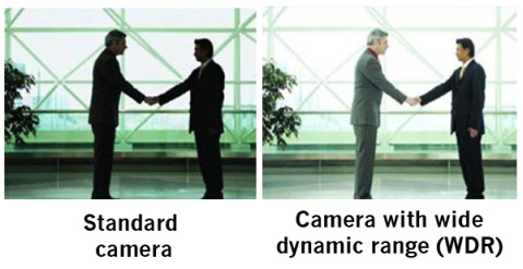

Do you mean to say a lens that can both dim the arc while keeping the remaining view brightly lit?
With photo/video cameras this is called dynamic range.
Cameras with a wide/high dynamic range can simultaneously record the darkest and brightest areas with far more information. They are also super expensive like $20,000... $30,000? Consumer cameras have far less dynamic range which is why our photos and videos do not look like what we see in the cinema.
The workaround to this problem with cheaper cameras is to try avoid scenes that have both bright and dark areas and be more selective with either mostly bright or mostly dark. With welding this would mean trying to make your welding area very bright.
- WD-range-compare-480x247.jpg (61.76 KiB) Viewed 2050 times
