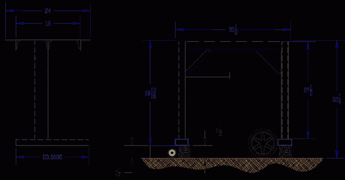

I made my from scape
Here the drawing and a photo

- welding-bench-Drawing.gif (21.42 KiB) Viewed 10744 times
- Work bench 2016.jpg (77.43 KiB) Viewed 10744 times
