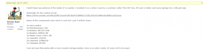

I found this post while searching for info to build my own foot pedal (as the C100F goes for rediculous prices overhere also)
Whilst searching the net, I found a PDF with the schematic. I'd think it would be the same for the remote (minus the on/off switch).
No Idea how thrustworthy this is, but it looks legitimate.
Hope it's of help!
Hope it's of help!
- Schermafdruk 2019-06-10 13.06.55.png (249.97 KiB) Viewed 3027 times
Wow, this looks very promising. I'm going to have a look inside the machine to see if the letters are marked on the connector.
Thanks. This is probably what's on the little PCB that DennisCA made for his pedal project (on this forum).
Edit: Are you able to make out what the three Zeners are marked?

I found some info concerning the components on another forum.
- Schermafdruk 2019-06-10 14.06.25.png (73.29 KiB) Viewed 2993 times

I can attest that the schematic works.
I just finished my pedal made out of a Behringer FC600 volume pedal and some bits and bobs.
In the end it probably cost me less than €100,00 in parts and a couple of hours of tinkering.
