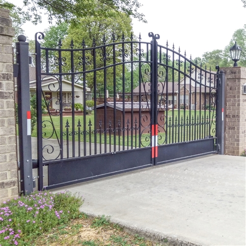

I have a good idea of how to build the gate itself but need recommendations on gate openers and hinges. Basically it is going to be a 2 door driveway gate with electronic openers. Im making it out of 2" x 1" for the frame and 1" pickets. The hinges have to be bolt on, this I where I need recommendations and also on gate operers
Design as pictured but split in half
Edit: gate will swing open electronically
Also need the recommended gap in between the center of the 2 gates

I hope they are tethered at the top to prevent them from being pulled over. A freestanding 4x4, no matter how well planted will sag with the weight you are planning.Krazywelder wrote:Steel. They were set in the ground by a company my dad had hired
Krazywelder
- Krazywelder
Joined:Mon Apr 06, 2020 3:21 pm
This is the setup with nothing at the top. How would you go about tethering it in to the column?

The picture is of the same setup of the gate I am building. I'll be using my everlast 211 on it as I've used before when building a dock gate. Prefer to run off 220 but I did the dock gate of 110 and worked fine.
I'm hoping someone can explain how to tether the existing posts into the columns to avoid sag. The rest of the dimensions i can handle at this point.
Is that gate yours or a sample you want to copy? I believe Most of those fences are aluminum. That is alot of weight and leverage. Here is a small 5' gate i built out of solid 3/4 pickets and i learned why they use aluminum. The 8' panels had to weigh 300lb. Never again! I used 3/4" hangers and forged the eye to match. Remember torque! If you have 100lb 6' out, you have 600ft/lb of torque. If you go with steel tube i believe will need a cable from the top post side corner to the bottom middle corner to prevent raking and as others stated the post holding this will need to be solid.

I would fabricate a latch plate near the top of the 4x4 and lag that to the masonry column. That prevents the post from being pulled away to the center of the gate opening.Krazywelder wrote:This is the setup with nothing at the top. How would you go about tethering it in to the column?
One reason you often see horizontal “rungs” where the pickets pass thru is to assist with preventing racking. It’s also why flat stock, not tubing is used in those type as flat stock with broached holes distorts a lot less.
There’s lots of ways to skin this cat. Just factor in the weight of things, and be aware you can likely use thinner wall, and smaller scale pickets to achieve a lovely outcome. Like your dad’s (if that his in the picture, handsome gate)

Here is a water department gate across the street and they used 6"square post and a chain anchor to help support. Without the chain it would likely not line up over time.
Sounds like the op has a stone pillar to connect to so he should be good.

Buddy pushed a very large I beam 9-10 feet into the ground with the excavator. That was the main post that the gate hung on.
I made hinges with 1/2” plate and pipe pieces welded onto the plate. The gate then has a smaller piece of pipe on a plate that fits into the larger pipe that’s beveled and welded to the I beam post.
The other end of the gate just needs a smaller post pushed into the ground for stoking the swing and locking purpose.
The lower of the 2 hinges had a drilled hole through the pipe and plate for water drainage.
I would also drill a hole in the lower section of the gate support frame arm for water drainage. This ensures nothing will rupture or crack if it freezes in winter.
