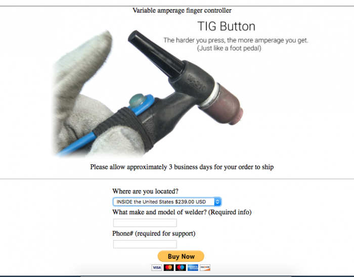

Hey Folks,
I did a lot of 'out-of-position' burning with my MIG. Now that I'm climbing the GTAW hill I'm finding the the 'pedal' is sometimes a pain. I'm not saying that it does not have a place. Most times it is indispensable.
I have researched some old posts and found one that 'Oscar' posted back in 2013. He purchased a 'finger button' that was pressure sensitive and indicated that he liked it..... Oscar, you here???
So, I've found it on '6061.com'. Do any of you have input??? And, is their site worth the $65 to join???
Thanks.....

I saw that exact same button on 6061's YT channel not long ago. Seemed interesting, and it's hard to argue with his results, so I looked into it. Seemed like a hassle and a bit cloodgy to get it integrated into the machine, and the price tag (I think about $250) turned me off to it. Not that the nice remote amperage controls from CK and others are much less...
Does seem like useful a tool, though. Interested to know if anyone else here is using one.
As for paying $65 to "join" and unlock his other videos. Nope. Not for me. Too much other great content is already available for free from other sources. Now if it were a $5 or $10 "donation", I'd probably be more inclined to pony up the dough.
I have 2 of them; one on my Dynasty and one on my multiprocess Lift Arc box. I use them in lots of circumstances when a pedal (just as you described) is inconvenient.
You can buy the button through Aaron at 6061 or directly from Dave Vogel at https://www.tigcontrol.com. Dave is awesome to deal with. Aaron's site is chocked full of good info if you are getting started in TIG, and Aluminum especially. Sure, there's lots of other content out there, free in YT land. But Aaron makes exceptional videos, great, well-documented content, and for $65 its a contribution to someone willing to share decades of skills and insights. Cheap education in my book.
I don't disagree. I'm curious though if he did any sort of market analysis to come up with the $65 figure or if he just sort of threw it out there. I'd be willing to bet that if his subscription cost was say $9 (about 1/7th the current total cost) that he may be able to get at least 10-20 times the amount of subscribers willing to pay, and a lot more total revenue coming in from the subscriptions. Since it does not cost him anything to bring on more subscribers (maybe a relatively negligible cost if he had to increase hosting bandwidth), $65 just seems like an odd choice to me. A lot of people are willing to pay $9 for that type of service, who would not be willing to pay $65, and I'm definitely one of those people.cj737 wrote:...But Aaron makes exceptional videos, great, well-documented content, and for $65 its a contribution to someone willing to share decades of skills and insights. Cheap education in my book.

I've looked at this finger button amp control, it's interesting and would have it's place. But it's not for me. Doing mostly pipework, I know exactly what amps I want for every pipe size and schedule so I don't need amp control, only stop start. The peddle is ideal for bench work, but torch switching is best for positional work. That gives me two options - lift arc and 2T switching. I use both and have a momentary switch fitted to my torches.
I believe if you focus on reading your weld pool, travel speed, torch angle and arc length you don't need continuous amp control, and you can always pulse with the 2T button if things are getting too hot.

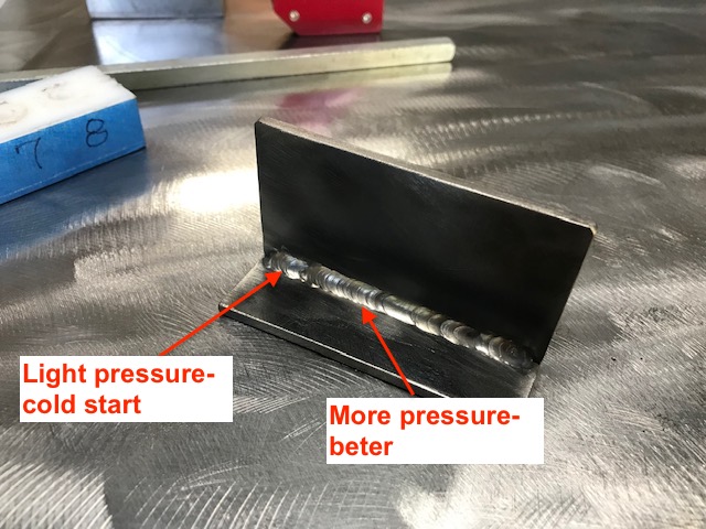

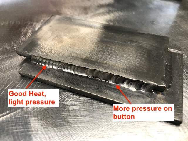

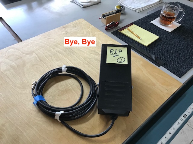

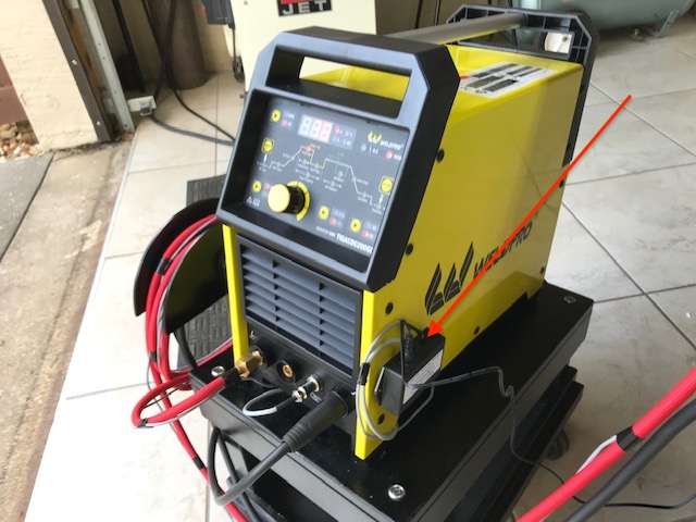

v5cvbb,
Similar to you I was having issues with the foot pedal. I contacted Dave at TIG Control and he put me in contact with his partner Gary. This was because they did not offer the button for my welder.
Gary and I worked together in developing one for my welder. Last Monday I received it, I installed it, and my world changed. The install was simple and usage is very intuitive.
Dave and Gary were great to work with. They accepted the challenge and came up with a button quickly. Good folks...!
I've been playing with the button for a week now. Tried up and down the amperage scale and pressures on the button. It is great.
I also need to thank Oscar for his posts on this site. I think his first post was in 2013 and he now is using three of these buttons.
Anyway, here are some photo's of my install....

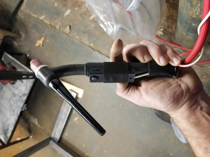

Burning filler rod, any idea about the different style buttons? I've seen 2 versions and expected they were old and new. I just received mine last week so ours should be current generation. No complaints, just curious. I mounted my box in exact location you did, but with the jacks facing down. I made some elastic loops for my last on/off button which worked well with this one.
I'm new to the forum and I couldn't find the guys at ARC Control online and didn't know where the button was coming from until the box arrived. Glad to hear they are helpful. Aaron at 6061 answered several question before I finally ordered so I'm good with ordering there.

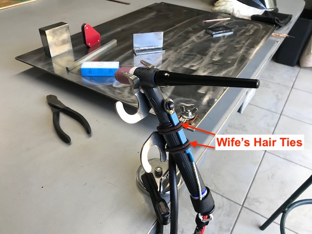

v5cv66,
The type button you have is the new and most current one. The button I requested Dave and Gary set up for me is, how can I say, more fragile than what you have. You need to understand that I'm not in a commercial shop environment and will always be the sole user of my torch so I like the streamline-ness of the way mine feels. I don't need the armor plating like on the Abrams tank, but I can certainly see the advantage of it in a rough environment.
After a week's 'honey moon' period I removed the white tape and conned my wife out of two of her hair ties. Now I can slide or rotate the button for any finger position I might need. (see photo)
I have to say again how impress I am with Dave and Gary. They were really up to the challenge for developing a button for a new welder. Here is Dave's e-mail for welders not on 6061's list: dave@tigcontrol.com
Good luck and enjoy....

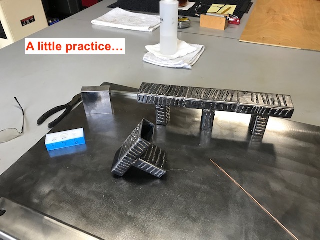

Weld Photo's Below:
1/8" (0.120" actual) Cold Rolled Steel
Peak Amperage 130
3/32" Lanthanated Tungsten
1/16" ER70-S
Furick Stubby Gas Lens
#7 Ceramic Cup
Argon 8 cfg
