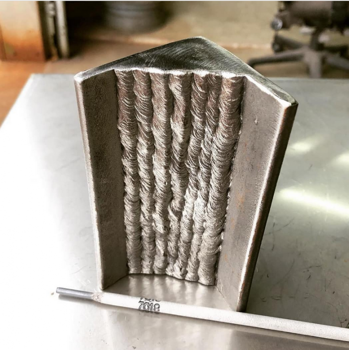

I've been looking at an pedal capable inverter welder to replace my big high draw buzz box and to give myself added tig capability and while I've been looking at the range of everlast machines from 400-1000 because I'd wanted arc force and 6010 capability but anything else in the price range either comes incomplete without a torch, pedal etc, has much less amperage, no pulse features, etc. I know that 9/10 if I need to stick weld all I need is something that'll manage to run a 7018 at 120-140 amps with a strong preference to be able to run a 5/32 rod if need be. But If I need to tig weld it, I might very well need the control HF start, pedal control would allow.
Re: Thoughts on Everlast Machines??
Posted: Sun Apr 19, 2020 11:16 pm
by TraditionalToolworks
sbaker56 wrote:I've been looking at an pedal capable inverter welder to replace my big high draw buzz box and to give myself added tig capability and while I've been looking at the range of everlast machines from 400-1000 because I'd wanted arc force and 6010 capability but anything else in the price range either comes incomplete without a torch, pedal etc, has much less amperage, no pulse features, etc. I know that 9/10 if I need to stick weld all I need is something that'll manage to run a 7018 at 120-140 amps with a strong preference to be able to run a 5/32 rod if need be. But If I need to tig weld it, I might very well need the control HF start, pedal control would allow.
Well, as I've stated I won't buy anything else from Everlast or AHP (same company through incest).
They do have a machine, the Power i-Tig 200T which has a foot pedal and does 6010. I have a Power i-Tig 201, it doesn't do 6010, but does 6011 (I'm ok with that). Mine didn't come with a pedal as you point out, I bought one after when they had them on sale.
If you need AC you will probably need to step up to the 210EXT to get 6010, otherwise I think the others are limited to 6011.
I personally don't recommend buying an Everlast machine, it's your choice, but if you do I hope it works out for you. ;)
The Primeweld is worth looking at, but it's not known for it's stick capabilities and I was on the fence because of that. However, the owner said he would refund and pay for shipping if I wasn't satisfied. I don't think I'll be sending it back as I want it mostly for it's tig ability. Heck of a deal considering it comes with a 3 year warranty with shipping paid for if there is a problem. That must be putting pressure on Everlast/AHP, their service and support sucks and they charge for shipping.
If you're planning to tig weld you DEFINITELY would be good to get HF *AND* a food pedal, I agree. I wouldn't want to tig without both myself. It can be done, but mostly on old transformers is where people do that with lift/scratch and no pedal.

Have you actually heard anything about less than stellar stick performance with the Primeweld? Or is it merely that it doesn't have hot start/arc force and 6010 functions in comparison to the everlast models for example. Those features are nice, and definitely something i'd at least like to have, But in comparison to having more amps, not having to pay extra for a foot pedal and even having AC they're not as important, the 210EXT would probably be preferable for also having stick features, but it's twice the money.
I'm also fairly disappointed by how you and occasional other reports I've came across say Everlast treat's their customers, regardless of it I'd need the warranty or not, I don't particularly like supporting companies that don't treat their customers with respect or patience and I've heard nothing negative in comparison about Primeweld.

Mike's response was actually good enough to convince me to pull the trigger, and a couple hours after I did they sold out just like Mike said. I had been on the waiting list and was waiting for about a month. I was alerted the day before and was on the fence. If you look through the Primeweld thread here in Product Reviews, you will see where I say I'm gonna bow out. For some reason towards the middle of the day I decided to try to contact Mike. He did get back to me promptly.
I have laid everything out on the table for you to see. Originally they put them on sale on the 9th, they said the machines would ship on the 16th-17th. My machine shipped on Monday, April 13th, so they beat their schedule by about 3-4 days. I have no stake in their company and haven't received my machine until Tues.
Here 'ya go, I grabbed it off Instagram with gnome-screenshot. ;)
I looked a week or so ago and couldn't find any good example of stick, this was one of the first I saw. The guy got pretty heavily criticized, telling him to keep practicing and how their teacher would have never accepted a weld looking like that, etc...but he does some pretty good looking tig welds. IMO, there not the best 7018, but certainly not the worst. Looks like it could be a bit hotter to wet in, but not too bad. Others here might have a different opinion. This is a 3f, so keep that in mind, it's vertical.
7018 in the 3f position (vertical) done with a Primeweld 225

The welding world either has bigger or more fragile egos than just about any other field I've seen. I'd damn well hope someone who did it for a living would be a better welder than a hobbyist. I don't see any reason why it's particularly unacceptable or deserving of harsh criticism if not asked for. I mean I'm not saying it's good, but like you said the only real t issues on a hobbyist level is that it's a bit too cold and inconsistent travel speed I don't see any slag inclusions, or severe undercut, a bit of a porosity towards the start which is common with improperly stored 7018 and re strikes but nothing bad. I don't see any thing that looks like it was the machine's fault though.
Granted I'm not that good of a stick welder myself. This was a picture I took a few months ago. I believe it was 3G unless I'm remembering wrong. But I've gotten similar welds with everything from an XMT 350 to AC/DC buzz box. I've found the brand of electrode makes more of an difference than the machine unless It just flat out won't run smoothly.
Posted: Mon Apr 20, 2020 9:12 pm
sbaker56 wrote:I've found the brand of electrode makes more of an difference than the machine unless It just flat out won't run smoothly.
Indeed, Lincoln Excalibur being the best of the lot. ;)
