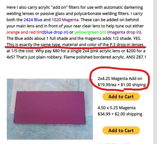

The one you got should have been $79.00, less the discount if you took that. If you're referring to the 4x5 lens, that site linked above doesn't even offer it in that size. Only the half-lens.LtBadd wrote:I bought the Phillips drop in magenta filter (not lens), that's what I was referring too in regards to price.
Location:Orlando FL
This is what I was referring to as far as price comparison, found on THIS pageBugHunter wrote:The one you got should have been $79.00, less the discount if you took that. If you're referring to the 4x5 lens, that site linked above doesn't even offer it in that size. Only the half-lens.LtBadd wrote:I bought the Phillips drop in magenta filter (not lens), that's what I was referring too in regards to price.
- Annotation 2020-07-27 182024.jpg (84.42 KiB) Viewed 4847 times
So why does a two-by-four on their own page cost either $30 or $120? I don't doubt for a minute I got ripped off. I'm still happy with it. It was still less than my Hobart helmet that eats a set of batteries literally every single day.
Location:Orlando FL
I was referring to the link kiwi posted above which you quoted.LtBadd wrote:Can you post a link to the $120 option? Are you looking at the purple or something else?
After I clicked that I chose magenta Madness in the lower left when it cycled to that link. That took me here where they pretty much look like they're as expensive as anywhere else. http://www.opticoolweldinglens.com/tig- ... trast.html
