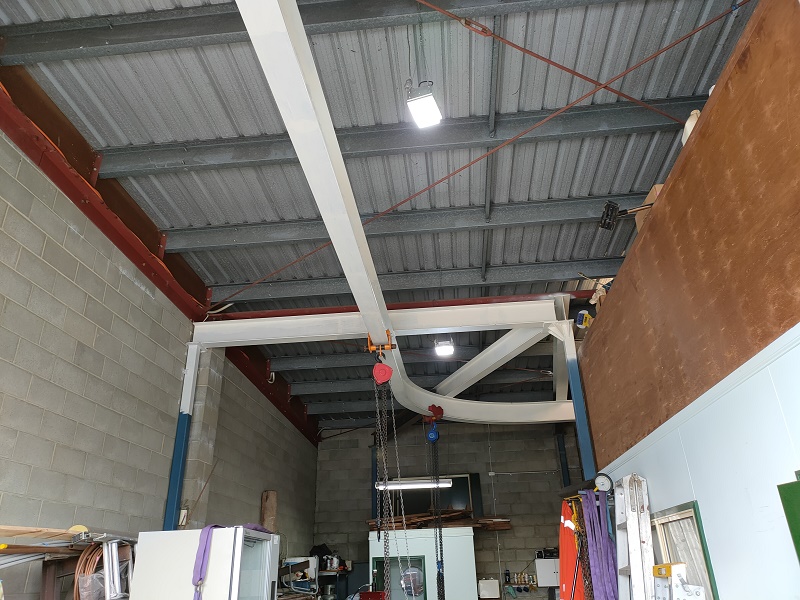

I have a 4T monorail with a rolled turn to get around back of the front corner office. Fitted with 2 x 2T girder trolleys and chain blocks. Use it all the time. Don't need or own a forklift.

can you post pic or describe in more detail? I'm sketching out storage above the carved out 12x12 closed off room since i will have another 4 feet space above it to the building ceiling for storage and obviously lot of longer steel sticks can/will go up there.

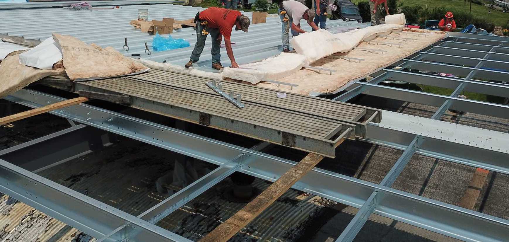

I've got a man-basket here also, and I use that with the forklift for everything. It's many years old and I am likely to build a new one soon with the intent of making it with a 1' platform to help with the very last bit of height I need. My lift truck is limited to 180" height, and my ceiling is 'just' high enough that I'm forced to stretched to reach, so I'll be making a new one with a slight additional lift. I don't need much. I also have 8' fork extensions (super heavy, >150# each) that I use with the basket, and that helps me to get to all the hard to reach places. My forklift is a 'reach' truck, so it's got a scissors extension that gives about an extra 3' of reach. When an item has open area underneath with legs on the floor, I can drive the lift truck feet under it, and reach a total of 11' past the mast. It's awesome for hard to reach areas over machines and tables which are too heavy to move.
I've noticed 'some' noises, but I don't sleep here at work so I don't care. There's no where near the noise I was expecting. I'm doing maintenance and office work today, and it's silent out there. I'd be hard pressed to say there's any noise from the roof. Keep in mind, mine is really standing up on 'stilts" with those bridges. So there's almost no mechanical connection to the steel structure.
Here's a pic taken with my drone during the construction. You can see the bridges out ahead of the guys. There's a layer of insulation under the roof panel where they are, so really I'm not hearing much noise. And today is broken clouds with lots of sun, so I think this would be a bad day as they go. Not as bad as winter, but I don't often come here and there's no machines running so it's unlikely i'll hear the roof much.
- Dji_0147 - Copy.jpg (168.29 KiB) Viewed 11596 times
Here's a better pic of the bridge gizmos. There's also those tabs in the foreground that have the piece sticking up that gets rolled into the roof seams to hold it down.
The bridge is screwed down, then those little tab things get screwed to the top of the bridge, then the roofing goes on top of that.
- Img_0423.jpg (177.55 KiB) Viewed 11585 times
