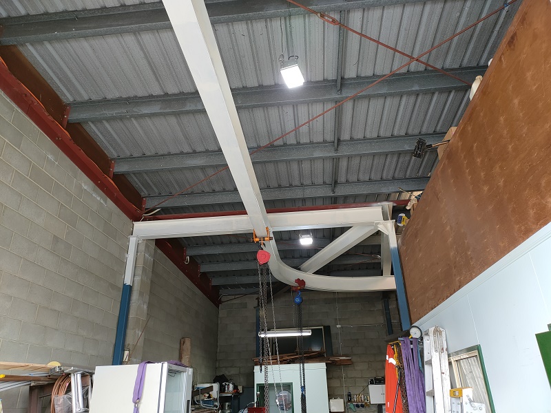

I have a 4T monorail with a rolled turn to get around back of the front corner office. Fitted with 2 x 2T girder trolleys and chain blocks. Use it all the time. Don't need or own a forklift.

Coldman -
can you post pic or describe in more detail? I'm sketching out storage above the carved out 12x12 closed off room since i will have another 4 feet space above it to the building ceiling for storage and obviously lot of longer steel sticks can/will go up there.
Thank you everyone already for posted comments/suggestions. Already am increasing size as budget allowed me to go to 40x50 and also have idea for how to wall off entire combing plywood sheets and white metal. thanks BugHunter for reminding me of the wall mount openers = i really had wished i had those in my old shop and forgot about it.
