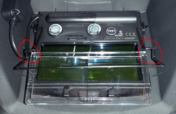

I've got a new Lincoln Electric K3419-1 and an offical Lincoln cheater lens I bought which measures 2" x 4.25". It's possible I'm completely missing something, but I can't get the cheater lens to fit! There's some kind of plain plexiglass lens on the inside that came with it, but it measures 1 7/8" x 3 3/4". There's sticker inside the helmet that lists the part numbers for different lenses for the helmet, but if you look them up they're all 2" x 4.25" which is too big! It doesn't fit in the cutout where I assume it's supposed to go (where that smaller plain lens comes out).
The part numbers listed in the helmet are: KH637 (1.5x mag), KH638 (2.0x mag), KH407(2.5x mag).
Pic shows cheater lens where it should go, but the wire will not fit over it and clamp.
cheater lens snip.jpg (47.9 KiB) Viewed 7069 times
I don't have that helmet, but could it work to slip the lens on top of the wire, only under the circled corners, and lock it down by the wire catching the lens sides with the bends in the wire?

Thanks for taking a look. It's not ideal but it works. The lens slides around a bit while trying to get the wire over the tabs. The lens is so thick it takes a little effort to get the wire down under the tabs. I think it's just a really bad design. When I get a chance I'll cut some grooves in the edges of the lens with my CNC for the wire to fit into and reduce the thickness.
The next problem is when I flip the helmet up I still need to put my glasses on to see. So even though the cheater lens seems like a good idea it just makes it a hassle to switch back and forth to my glasses.
