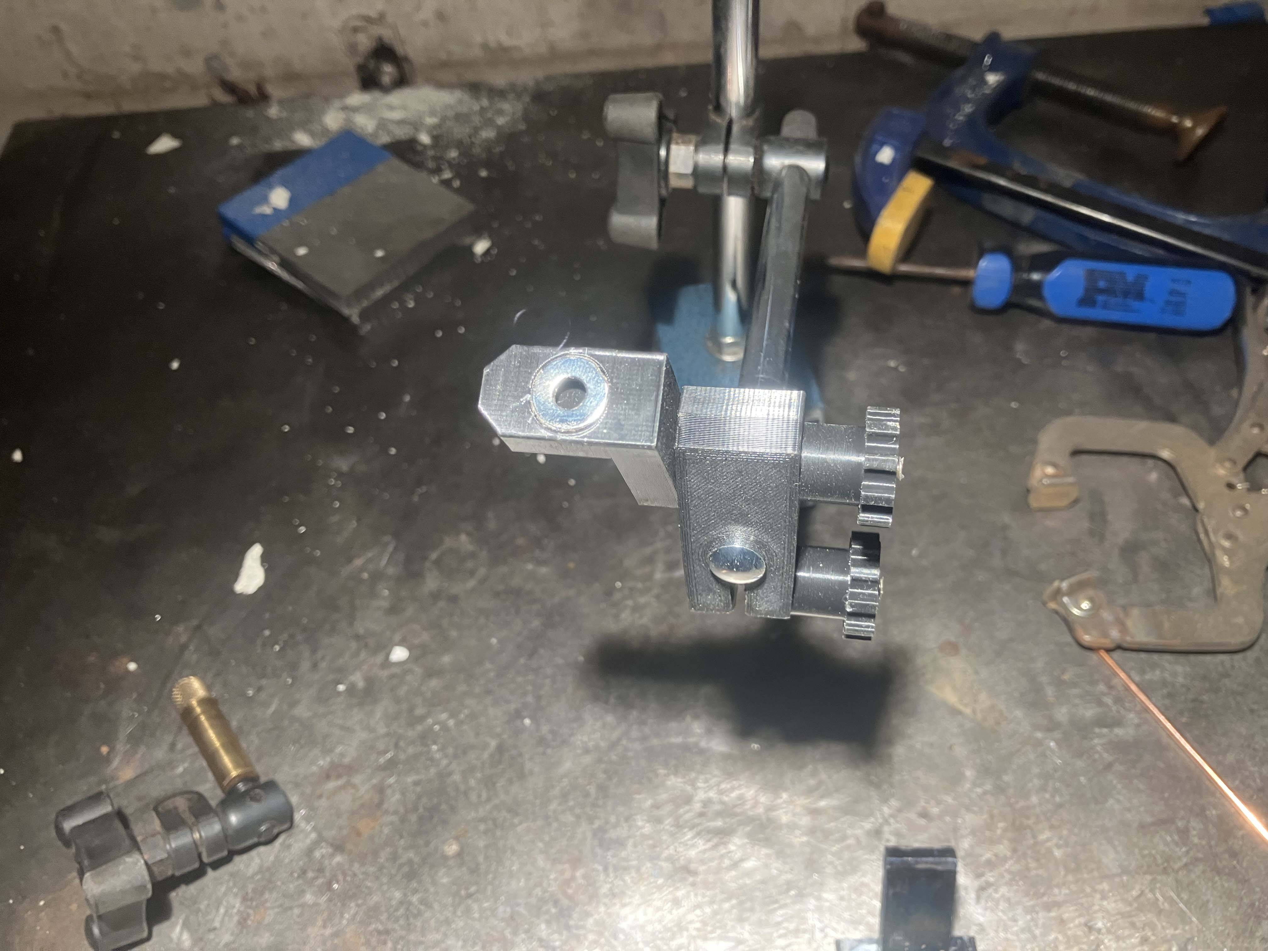

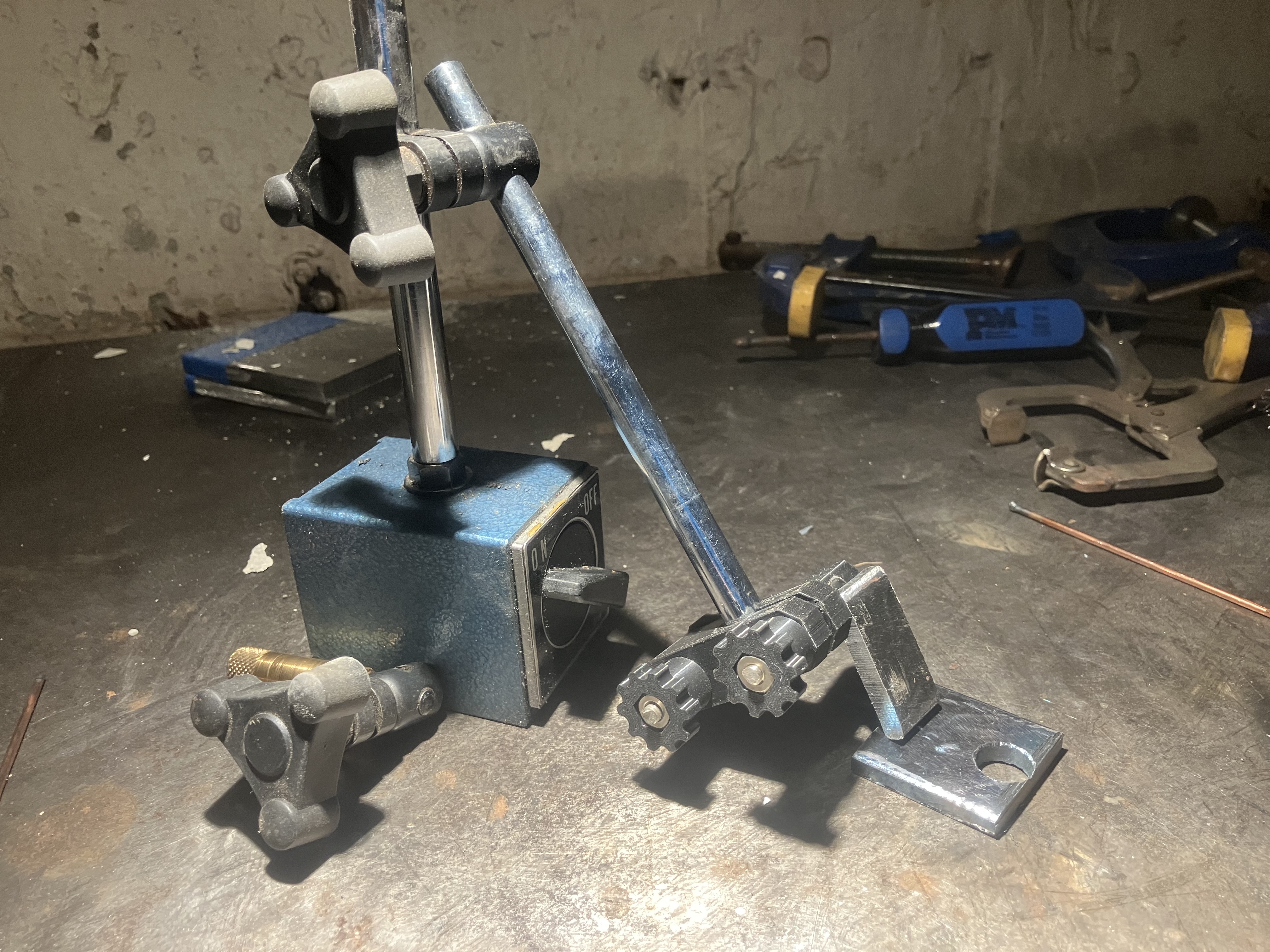

Holding small pieces at odd angles has always been a problem for me. I am have made a proof of concept magnetic fitting for a magnetic dial indicator holder. While the one I made was on a 3D printer is very heat sensitive it does work. Just some food for thought one of you may find a better way to do it.

As Cj stated, magnets interfere with tig welding and I've had magnets interfere with mig welding. When I need extra hands, I use a "third hand" that I put together using a connecting rod from Caterpillar engine and pieces of 1/4 inch round stock. Nothing fancy but gives me that extra support.

I can usually hold it "pretty close" and get 1 small tack on it, then adjust from there. It's pretty easy to bend one small MIG tack.

That looks like a good solution. For me, the hardest thing is clamping something that is curved. Clamps want to slide off.
