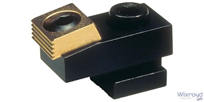

Hello delraydella
That is a nice rotary table. It looks like it is a compound sinus rotary table? Those are especially nice. I was giving your question on how to best repair the tool some though and came up with this idea. I agree that in this case there are better options than welding. And since you already have a milling machine , the battle is more or less won.
My recommendation is to machine a flat surface ( face mill ) on the side of the rotary table where the mounting feature is broken off. The surface must be parallel to the center line of the two intact mounting features and perpendicular to the rotary table’s mounting surface (bottom). The surface will provide you a flat contact face to utilize a toe-clamp for milling machines like the one in the picture I have provided (fig.1) . There are many different sizes and styles. They have a low profile and will be underneath the plane off the rotary table work face. These style clamps, are compact yet are capable of producing very high clamping forces more than sufficient for your application as the "4th hold" on you rotary table . By using the three existing mounting features plus the toe clamp as a substitution for the broken off mounting feature, I am certain the tool will remain secure for any job you can set up on it. I also think that with a milled face, the rotory table will no longer look "damaged" which is good if you ever give some customers a walk through of your shop.
If you are concerned with vibration I suggest using split ring compression washers on the bolts. Such washers are not required for the toe clamp however.

- fig.1
- TOE CLAMP.jpg (15.81 KiB) Viewed 2011 times
Nice!
That's almost exactly what I had envisioned in my suggestion of building something akin to a carpenter's "hold fast".
As an ameteur machinist, I was not aware this was commercially available, T- slot base and all. A neat solution to his problem.

Hi, LOL....a toe clamp....sounds like a medieval torture device that goes with the thumb screw.
Now, that device will be handy for all those large area surfacing jobs where a vice doesn't open enough or the plate is too big for any vice, or any piece of material that needs a surface machining operation before surface grinding etc....round discs come to mind.
They could also be used to hold a job on an angle plate, provided the angle plate has T slots etc, but it looks like the T nut base can be removed, so no problem.
Hey, take it a step further and you could use them to hold a job on a face plate in a lathe for facing off without the clamps getting in the way.
With that thought in mind you could also have a very large face plate chuck with multiple jaws.
Toe clamps!!!!!......... gonna go on Ebay and see if any's being listed.

Thanks fellas!!! Those are some good solutions!.....I think the toe-clamp idea is a great one and should work very well for this and many other clamping problems. I really like the idea of using them in the lathe for facing off thin pieces, too. Right now i'm looking at a job that would require facing several thousand pieces of 1/2 and 3/8 inch thick aluminum rounds, so they could work well there too.
